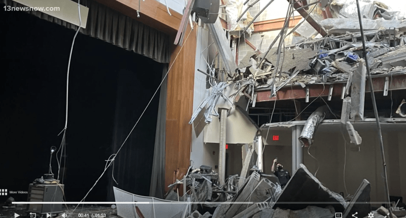

Whenever I see a new collapse thread, my first thought is: what kind of precast this time? And more often or not, there's a pile of hollowcore planks or some such laying on the ground. Maybe that's just me...
bones,
Agree, but looks like steel trusses this time.
Steel truss, metal pan, with insulation on top covered by membrane roof is a common construction here. This system is often used on local school buildings. <Guess> This MIGHT be the system used here.

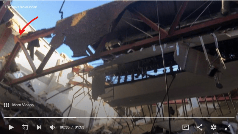

Here's a video cap from one the news articles. Looks like HC planks spanning between trusses.
Do you guys reckon this truss failed? Looks like the first diagonal is gone.
Possibly. Looks like there's a steel column and CMU wall back there that probably aligned with and supported that truss.
