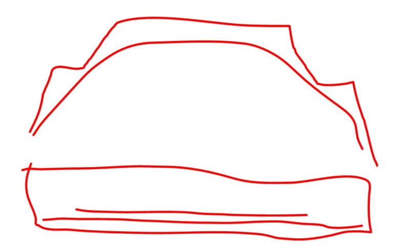

Agreed. That's how I see it in software, textbooks, and practice. Basically the sketch below where you construct a flexural demand to capacity graph that acknowledges the available tension picking up as bars come on line.
Is your question really whether or not the above is appropriate? Frankly, I question that myself. Once one commits to a flexural capacity calc that assumes that the concrete and rebar hit plastic strain levels (0.003 / 0.002 ish), it seems to me that that all bars on either side of the study section need to be fully developed. The best I can tell, we must implicitly assume that the new bars coming online accrue stress slowly and probably are not fully in adherence with the plane sections remaining plane assumption.
I feel that it is accurate to say that new bars coming online represent a local, disturbed region rather than a Bernoulli region.
