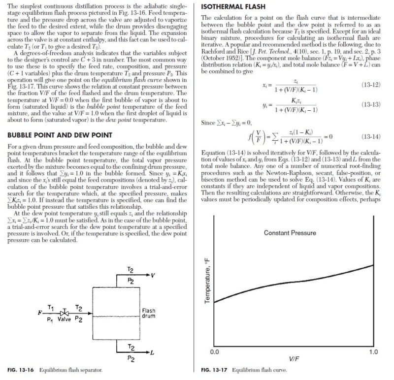

I have been scratching head on these two thermodynamics questions. Can anyone shed some lights ? These two questions are all related to phase equilibrium.
PE Reference:
The term z in these questions is not well described. Context to these questions is in Perry Chem Engg Handbook 7th edn Chapter 13, section on Single Stage Flash Calcs, where z is described. Answers will then be obvious.
@georgeverghese
Thank you for the direction. I believe here is the reference you were referring to. With this, I am still having hard time to solve these two problems. Can you explain in details ?

In that same chapter of Perry's, find the section on "Prediction of K Values". You should find some DePriester graphs of K's for hydrocarbon systems. Pick a component, and develop a general understanding of how K behaves with constant P and rising or falling temperature. You should learn that K at constant pressure increases with temperature. Then, use that knowledge along with the sections you posted above to rationalize the answer to problem 509.

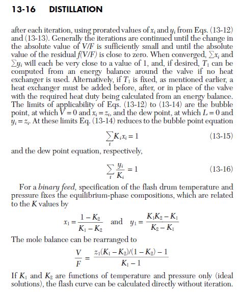

The answer is D if I am correct. At bubble point, Sum (KiZi) =1. At dew point, Sum (Zi/ki) = 1. Within the two phase means the temp is between bubble point and dew point temps. Thus, both Sum (KiZi) and Sum (Zi/Ki) is greater than 1.
Do you have any idea about problem 510 ?
@AthlonXPme
We know that TBP < TDP. Let's take them from lowest to highest.
At TBP Sum(KiZi) = 1. If we raise T above TBP Ki's will increase and Sum(KiZi) > 1.
At TDP Sum(Zi/Ki) = 1. If we lower T below TDP Ki's will decrease and Sum(Zi/Ki) > 1.
I agree, both Sum (KiZi) and Sum (Zi/Ki) is greater than 1, so the answer is D.

Hints to solving 510:
a) When theta = 0, we have dewpoint; when theta = 1, we have bubble point. So temp is decreasing as you move down the x axis, and so K decreases for each component also, for non regular azeotropic behaviour
b) The expression for f(theta) can be teased out, with a little algebra on the PE reference 3.6.6.3, as being equal to Sum(y_i) - Sum(x_i). This is also the converse of equation 13-14 in Perry

The y axis can be viewed as a residual error term. Solution is reached when the iteration value for theta results in y=0.
To see which of these curves matches our observations, we find the first derivative of this residual
Rewrite this expression as y = Sum [a(c-1)/(b +(1-c)x)], where x = theta; c = K_i, which is always positive
dy/d(theta) = Sum [a.(c-1). -(1/(b+(1-c)x))^2 .(1-c)]
or
dy = Sum [+a.((1-c)^2).(1/(b+(1-c)x))^2] . d(theta) -equation 1
d (theta) is the (next iteration value of theta, at which point the expected value of y is 0) - (current value of theta)
There is no local inflexion, and the slope of this line is always +ve.
The closest to these trends is A
It would be possible to use eqn 1 in a Newton Raphson type accelerated search algorithm to derive the next iteration value for theta if you were to write out a program to speed up convergence, as stated in Perry's Handbook.
Agree with George, derivative f{teta)is always positive.
y'= sum (zi*(ki-1) ^2/ ((ki-1) *(1-teta) +1) ^2 >0
y" cannot be zero.
answer should be A
