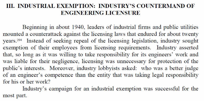

FBPE said:
[ul]
[li]"In-house” engineers employed by a manufacturing or other business firm not providing a service directly to the public;[/li]
[li]Engineers employed by public utilities;[/li]
[/ul]
As long as the service doesn't directly service the public...because utilities don't serve the public directly?

...why does the utility exemption exist anyway?
In a word... politics. The exemption applies to other industries in some states.
This is the paper that contains the extracts shown above: "The Enigma of Engineering's Industrial Exemption to Licensure: The Exception that Swallowed A Profession"
