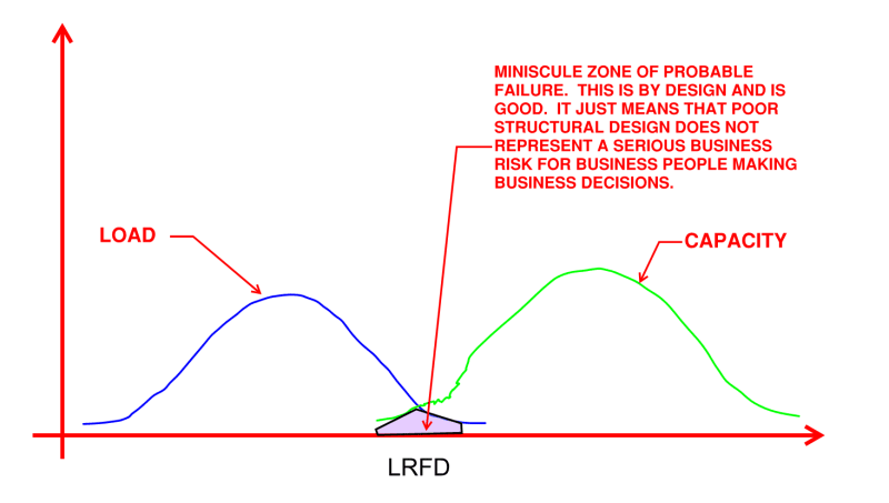

[highlight #FCE94F]I believe that the difference is that these other profession have something crucial that we lack: meaningful, measurable consequences that will manifest themselves over a time scale that would matter to someone making a strategic business decision.
[/highlight]
JSN said:
...the root of the problem...the quality of a structural design isn't always obvious to a client until a poor design falls down
Expanding upon that, I see it like this:
1) Because of the diagram below, the consequences of bad structural design:
a) Very rarely come to pass.
b) If they come to pass at all, do not manifest them selves for 50yr - 2500yr.
[highlight #FCE94F]2) The rarity and timescale over which the consequences of bad structural design manifest themselves is incompatible with the timescale over which human beings make business decisions. A such, it is simply not reasonable to expect people making business decisions to factor in the life safety implications of bad structural design.[/highlight]
3) We'll never have good structural design if bad structural design doesn't generate meaning consequences for people making business decisions.
[highlight #FCE94F]4) Since we cannot use life safety as a "business consequence" of bad design, we need to employ another, proxy consequence in its stead. I propose that consequence be schedule and, by extension, money. When people express concern that a rigorous peer review program would negatively impact project schedules, they are missing the point. The impact to project schedules is our stick. It is our "business consequence". Without that, peer review simply has no teeth and we remain stuck, right where we are. Forever apparently.
[/highlight]
Yes, it is wildly unfair other professions get to have "organic" business consequences whereas we're forced to invent faux consequences like this.
