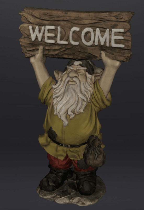

Dik, I have went down those rabbit holes as well. I wanted to reverse engineer some small parts of my own needs so I bought one of the Creality scanners. These are quite reasonable, but are consumer grade. It did not work very well for some of the parts I wanted to scan. It worked well for small objects, but I wound up getting a much better scanner. Below is one of my test cases. That is a scan of a 40" tall garden gnome that was kicking around the house. The consumer grade solutions in this market must sacrifice a number of things to get the cost to work to sell units. The software seems to suffer the most.
