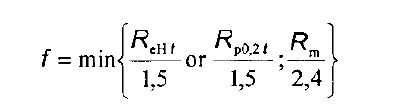

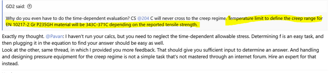

I have assigned to check the design pressure of a Seamless Carbon Steel Pipe (EN 10217-2 Gr P235GH or EN 1.0345) for DN 400 (OD= 406.4mm) line size with a wall thickness of 11mm. The fluid is Saturated Steam at 16 bar(g) ( TSat= 204.345 Deg C). I went through EN 13480 Part -3 and got the formula for Pipe Wall Thickness without any allowances or tolerances.
e =( pc * Do ) / (2* f*z+pc) ------> From EN 13480-3 : 2002+A4
where,
e = pipe minimum wall thickness, mm
pc - calculation pressure or Design Pressure, N/mm2
Do - Pipe OD ,mm
f - Design stress or allowable stress, N/mm2
z - joint coefficient ( z=1 for seamless pipes)
Now the question which sections of EN13480-2 and EN13480-5 should I refer to get the values of f and z. Going through EN13480-3, I see that f needs to calculated as the lower of Time Independent and Time Dependent stress. This calls for determining many other values such ReH, Rp,0.2,t, Rm etc. I want to get some help in figuring these out.
