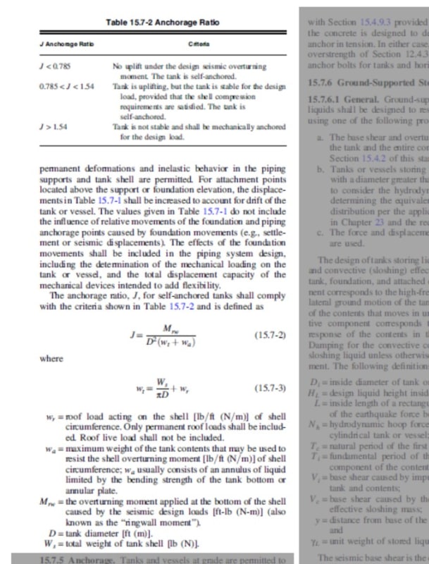

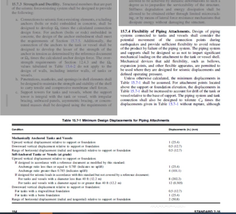

I'm trying to get a feel for what those in the oil & gas/chemical/industrial industries are doing in terms of pipe stress performed on piping connected to pressure vessels and exchangers. If you read ASCE 7, it is clear to me that the intent that piping attachments to all these pieces of equipment shall be analyzed to handle the movements in table 15.7-1 times Cd. This is very similar to API 650 Annex E seismic analysis. However, outside of API 650 Annex E tanks, is anyone running this 15.7.4 flexibility analysis on standard pressure vessels, exchangers, etc?​

ASCE 7 is the code for "Minimum Design Loads and Associated Criteria for Buildings and Other Structures" adopted as law directly or indirectly via IBC in just about all states in the US. I've attached one of the applicable snapshots. It has specific direction for piping connected to vessels and tanks and what needs to be verified for seismic review. I understand all the reference you posted; those are very standard resources for analysis. This ASCE 7 requirement is a topic I cannot find discussion on and the fact that it is adopted as law in states has me wondering what others in the industry are doing, if anything at all.

1503-44, while I agree with much of what you say, that is not how the ASCE7 chapter 15 is written based on my understanding. And being that it is adopted as law, one could not justify feelings on the matter as an excuse to not perform very clear directions provided by code in court of law. That is why I'm hoping someone can make arguments backed by evidence provided by verbiage in the code that proves my understanding incorrect. I'm hoping to be wrong on the matter, I just can't find actual justification in the code to do that. I too think this is over-reaching in design. But I can tell you after doing many of these analysis on tanks and vessels, this in fact quite often heavily drives design vs thermal expansion of piping. The commentary for 15.7.4 sheds a bit more light and I can wrap my head around needing to do API 650 Annex E analysis on large field erected storage tanks, but to apply these same requirements on ALL vessels of any kind is quite a different story! But that is how I understand the intent of ASCE7 chapter 15. Please read this chapter on your own and I would love for some other thoughts on the text that is written.

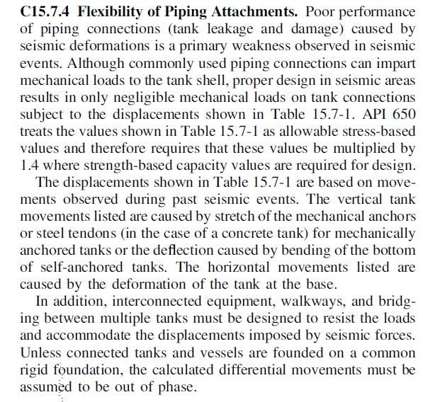

I agree with 1503 about arbitrary displacements of nozzles. Considering the forces and issues associated with ACTUAL vessel movements, I can't imagine the piping modifications needed to accommodate something as arbitrary as an additional 4" of displacement. Sure, in an ideal world we could throw an expansion joint at every nozzle to cover this arbitrary movement and the owner would keep up with it and maintain it. But that's not how it works in reality.
In my opinion the statement at the beginning of 15.7.4 is doing a lot of heavy lifting - "unless otherwise calculated use the minimum displacemetns in Table 15.7-1". Sure thing, I've got better info and I'm going to ignore those comical values.
RVAmeche, I again am not in disagreement with you. I would be interested in knowing your thoughts for calculating displacements other than table 15.7-1, again from a point of substance and technical backing that would hold up in court of law. I think there's consensus that the requirements spelled out in ASCE7 chapter 15 don't pass the gut feel test and are impractically overbearing, but unfortunately its published and adopted by law.
For pipe design purposes, 31E says "OR". 31E does not require that the ASCE given displacement condition must be the pipe design condition. That gives the piping design engineer the justification in court to say that he used the alternate, calculated criteria and that it was reasonable and justified by his expert opinions backed by his experience, which BTW are not "feelings".
In any case flexibility is not usually difficult to provide, providing that the piping engineer was thinking about that during his layout. What I see more times than I should is a long run of pipe going straight into a valve bolted onto a tank nozzle. It's not that difficult to put in a 90 or two, both horizontal or one vertical to get the required flexibility. I see long runs of pipeline running straight into a pig receiver at the center of a gas processing plant, then a huge pipe anchor block trying to stop the thermal movement, even at ambient temperature ranges. No bends, Nothing. Headers straight into the pump house. Those usually don't even work thermally in seismic zone 0. I think the general stress problem isn't so much seismic, it's much more attributable to inexperienced pipe layout artists. Once that gets into the plot plan, it's difficult to shake it out. As I said, in most cases, seismic amounts to getting the sideway under control with proper spacing between supports. The seismic stresses themselves are hardly ever a controlling case, unless you are in a really high seismic zone. Getting thermal under control, is the biggest headache.
I don't have a copy of the latest ASCE 7 in front of me, but I imagine it still has some sort of language saying "unless otherwise calculated" which, in my industry, it normally is. I'm not worried about this section in the least.

Seismic anchor movement (SAM) needs to be considered. Vessels, tanks, buildings etc do move around in EQ and the piping and the connected pipe needs to allow for this. A model of the structure is required to find the SAM. For large vessels it could be rotation of foundation giving the SAM.
