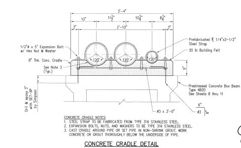

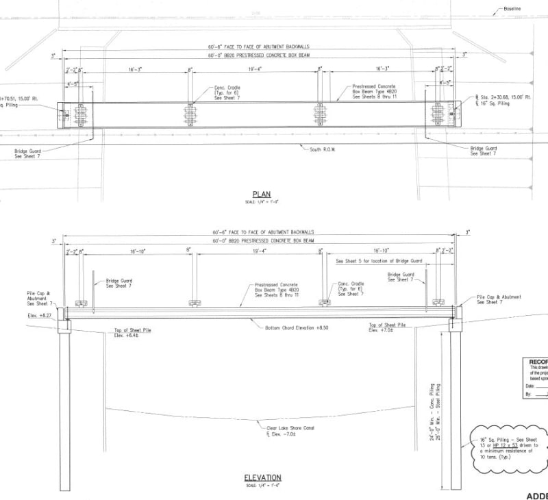

36" is a larger pipe, but engineers in my office have used a single pre-stressed bridge box beam girder to span creeks etc. Then, they have built a series of pipe cradles across the top of the girder at whatever spacing the pipe engineer wants.
Here's one with smaller pipes.
