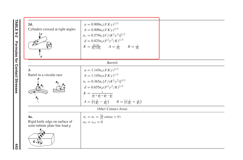

looks like this
Dear robyengIT , the formulas at TABLE 9-2 for contact stresses..and case 2d is for solid Cylinders crossed at right angles.
The thread is for the stresses developing at pipe resting on a flat bar. The stresses for this case largely depends on dia, wall thk, internal pressure , wt of content and developing support reaction and contact angle ...
Hturkak.
Read to read the OP more closely.
Says "round steel bar..."
Looks good to me.
Dear LittleInch (Petroleum) , Dear robyengIT (Mechanical)
The thread is for the stresses developing at pipe resting on a round bar. ( I made a mistake with writing flat bar in previous comment )
The formula suggested in (Walter D. Pilkey - Formulas for Stress, Strain, and Structural Matrices ) at TABLE 9-2 case 2d for contact stresses..
- The calculated stresses are contact stresses (HERTZIAN ) between two SOLID CYLINDERS crossed at right angles . The support , in this case round bar solid but the pipe is hollow cylinder..
- If the pipe is small dia with heavy wall thk (say XXS ) the assumption of solid cylinder could be acceptable. However, the calculated contact stress does not give an opinion for the max. stress allowable for the pipe at support. ( the local bending stress at support and longitudinal bending stress due to beam action shall be calculated to see the case)
Still i will suggest to look AWWA M 11 Steel Pipe A Guide for Design and Installation ; Chapter 7.
