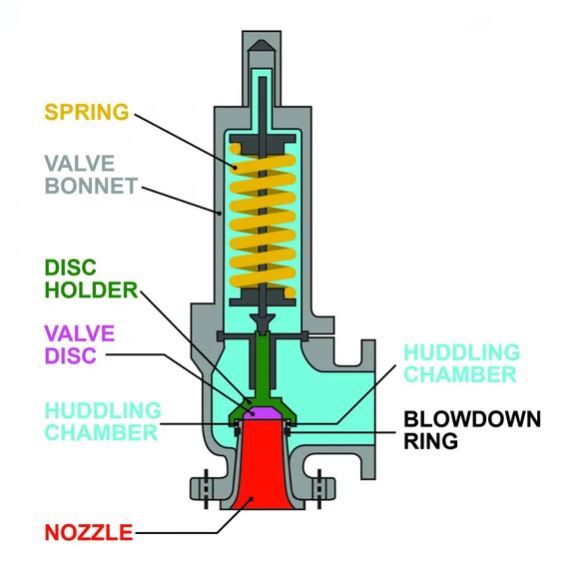

I'm a bit confused about the impact of pressure drop (inlet & outlet) on the Relieving Pressure (P1 as defined in API520, chapter 5.4).
Chapter 5.4 API states that P1, the pressure that is used in the formula to calculate A relief, is equal to the Set Pressure + the allowable overpressure. If we look closely, this is (at first glance) ALWAYS equal to the MAWP of the equipment + allowable overpressure (either 10% or 21% for fire case).
For calculation purposes, P1 is always the same, no matter what set pressure you choose. However, pressure drop over piping is not included (or deducted) from P1, see f.e. Figure 15 (API 520-1, 2014).
When I calculate the required area, according to input from my fire case, I get the required area which corresponds with the flow at MAWP + 21%. However, with that corresponding flow comes a certain pressure drop over the inlet/outlet piping, which ofcourse brings the pressure in the vessel during relief above MAWP + 21%.
One could easily say: OK, problem solved, just deduct the pressure drop from the Allowed overpressure, use the new P1 and calculate again. This leads to the problem that the flow itself depends on P1 - so I have to iterate again and again.
I also know about the rule that the inlet pressure drop is not allowed to be higher than 3% of the SET pressure (not MAWP!), and the outlet not higher than 10% (in conventional PSV's). These numbers are strange if one considers that the maximum allowed overpressure is 10% in normal cases. If these rules are followed, piping itself would excess the allowed 10% (3+10=13), let alone that you need to calculate (again) with a new P1.
Question 1: Why is P1 always the design pressure + Overdesign. This makes no sense. I have f.e. a vessel that has a design pressure of 30 barg, but I use it as atmospheric storage (still rated at 30 barg), the relief calculations are based on a relief pressure of 33 barg - where my set pressure is 100mbar.
This is an extreme case, but same applies for a SV that has a set pressure of 25 barg, the set pressure and used pressure to calculate the reliefload differs.
Question 2: How to deal with pressure drop in inlet/outlet piping. Do you really need to iterate the calculation untill there is a balance between the piping pressure drop experienced and the maximum allowed pressure in the vessel - or am I interpreting the API-520 wrong and is it allowed to have:

The 21%/10% are maximum allowable overpressures (of MAWP, not set pressure) in the vessel. You CANNOT exceed these values, and must account for discharge line losses in the design. If doing the calculations by hand, the normal process I like to follow is below. Assume for the moment set pressure = MAWP.
[ol 1]
[li]Use required relief flow rate to calculate PRV inlet and discharge line pressure losses. Set P1 = MAWP*1.1 (or 1.21) - inlet line losses and P2 = discharge pressure (atmos or header pressure) + estimated discharge line losses. If inlet losses are greater than 3% of set pressure for compressible fluids, you need to think about reworking the inlet.[/li]
[li]Use API 520 (assuming choked flow equation because of your MAWP and atmos discharge), P1, and estimated P2 to obtain a generic API area to get the approximate size of the valve. Find the next largest API orifice size. Use this info to find a specific relief valve model (see NB-18) to find a specific rated orifice size and discharge coefficient.[/li]
[li]Plug the rated orifice size and discharge coefficient back into API 520 equation to get a "rated" flow (still preliminary).[/li]
[li]Use this rated flow to calculate inlet line losses and discharge piping losses. You should end up with a different P2 (which should always be higher than your original P2 value because rated capacity will exceed your required relief capacity). If less than 3% inlet losses you can ignore the changes in P1.[/li]
[li]Use the new P2 and re-calculate outlet losses to get a new P2. Continue iterating until a stable value is achieved. Check to ensure this rated flow calculation exceeds your required flow. If rated flow is below required flow, select the next valve size up and redo the calculations. Check pressure ratio of P1 and P2 to ensure you are still choked through the PRV[/li]
[li]If rated flow is now > required flow, you now have your final design.[/li]
[/ol]
You will notice that P1 is always MAWP*1.1 (or 1.16 for multiple valves or 1.21 for fire case). It is NEVER allowed to exceed this. You seem confused on how the discharge pressure affects the sizing. It does not change the allowed overpressure. What it does is increase P2, effectively reduce the dP available for your PRV, requiring a larger orifice.
Your attached picture is confusing. Even assuming MAWP+overpressure = inlet pressure, you should have PRV relief pressure (P2) as well as relief line outlet pressure (P2 - line losses). There are only two pressures shown here. If you are going from 4.7 bara to 1 bara through the PRV, there is no question that you are choked. Most fluids critical pressure ratios fall between 0.4 -0.6. You are well beyond that pressure drop.
I agree. But I think I understand what is happening. What the tool does is the following; it takes the pressure where it is relieved to (almost always atmospheric in my case) and using that pressure it calculates the pressure drop over the outlet piping. This is 0.063 bar (outlet is a DN100 in this case) so P2 becomes 1.076.
However, then it does something that is not completely clear; it calculates if the flow is choked at the very end (at atmospheric pressure) which it ofcourse never is. It does the same for the relief pressure P1 - and ofcourse that flow is also subsonic.
It is the flow that goes through the nozzle, from P1 to P2 (4.706 to 1.076) that IS sonic. So sizing calculations for chocked flow need to be used. Which the tool doesnt do since further in the tool it indicates the flow is subsonic.
See attachment for full data - unfortunately I cannot share the tool here, but if we contact one-on-one I can show the full thing, I will post all relevant data below.
