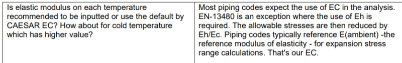

1. In the CAESAR load combinations setup window, a coworker advised me that the analysis should use Ec (Piping Elastic Modulus at ambient temperature)for all load cases, including those that include thermal effects. Results of interest for us are generally pipe stress and support reactions, and his reasoning was that this approach would yield conservative results for these values. This reasoning seems to make sense to me, but I wanted to confirm with other knowledgeable engineers. Also, obviously if deflection was a result of interest, using Ec would be non-conservative, correct?

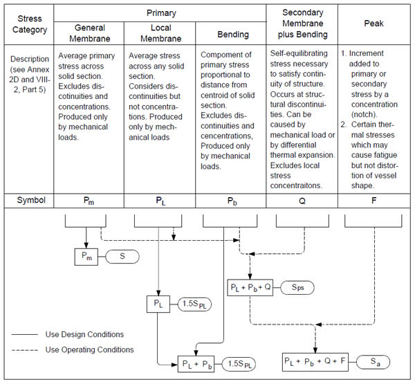

3. I also sometimes work with pressure vessel stress analysis, and I am pretty confused by the stress classifications (membrane, bending, “linearly varying”, secondary, etc), as well as the process of stress linearization. Does anyone know of a good resource to teach myself these concepts?

1. Not sure but I believe using cold modulus is correct. I don't recall ever having to calculate a hot modulus by interpolating tables of modulus versus temperature values.

3. A good description of stress categories can be found in Pressure Vessel Design Handbook by Bednar Chapter 2 - here is link
I don't have a comment on the EC approach - by default Caesar uses EC as you can see in the load case editor. I've taken the 3-day Caesar training and done other online training and never seen someone modify that field in the load case editor. Edit - A quick google found this in a Caesar webinar Q&A:
There are some codes that specify that the hot modulus Eh can be used for equipment nozzle loads given that Ec may be too conservative. So it depends on what you are doing and how sensitive your results at a particular location.
This might be also helpful (from a Becht blog). I can't recall if this is specifically in ASME VIII Division 2 where these would be more prevalent.
Not sure how to reply correctly on this forum but thank you everyone for your answers and provided resources, this was very helpful. Everyone seems in agreement that Ec is the conservative value to use for pipe stress and reaction forces. However would you also all agree that this value would be non-conservative if the value of interest is pipe deflection? And if not, why?

Ec isn't the "conservative" value for calculating pipe stresses per the piping codes, it's the requirement. For reference, B31.3 2022 section 319.4.4 calls this explicitly for flexibility stresses (EXP in Caesar).
For loads/reactions, you can use Eh at the operating temperature, though I don't typically take this approach unless the temperatures get to be above 800°F or so. That's where Eh drops enough compared to Ec to start making a meaningful difference. Caesar defaults to using Ec. You can choose which E value you want in the load case editor now. You could have a W+T1+P load case run with Ec for the code stress calculation and another case run with EH1 corresponding to T1 to give you restraint loads calculated based on the lower stiffness that EH1 should generate.
