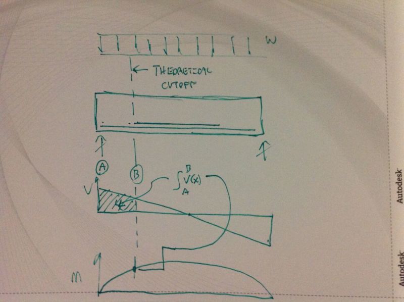

BAretired said:
Is there anything wrong with using VQ/I throughout the reinforced portion of the beam in order to determine the amount of weld required at every section?
Yes, for partial length reinforcing scenarios, I believe that there would be something wrong with it.
If the reinforcing extended full length and one provided exactly VQ/I the whole way, then the aggregate horizontal shear transfer capacity would exactly balance the force demand in the reinforcement at the location of peak moment.
If you cut the reinforcement short, and the horizontal shear attachment along with it, then you would not have enough aggregate shear transfer capacity to balance the force demand in the reinforcement at the location of peak moment. The shortfall would be MQ/I.
The above pertains to an elastic system but the same logic would hold were plastic section capacity required.

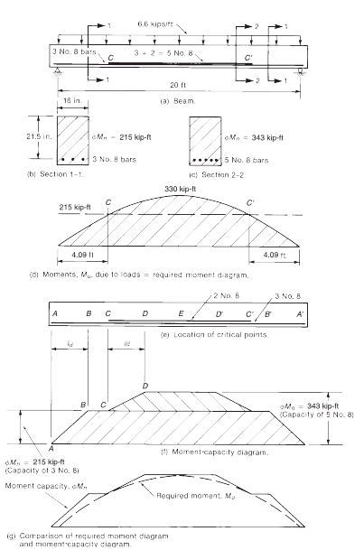

Referring to your sketch above, I would have said that the theoretical cutoff is the point where the full length reinforcement is just capable of resisting the moment Mb by itself. Beyond that point, additional reinforcement is needed to carry the surplus moment. Calling midspan point C, additional reinforcement is needed to carry Mc - Mb. In addition to that, however, the bars require a certain amount of development length outside the theoretical cutoff points.
The moment at any point x is equal to the area under the shear force diagram between the support and point x. That is not in question, but the amount of additional reinforcement is a function of the difference between maximum moment and the moment which the main reinforcement can resist on its own.
I don't think that is quite the same problem as we are discussing in this thread although there are similarities.
But Mc - Mb = Mc - INT(V(x))|A->B. So still dependent on the aggregate shear beyond the extent of the reinforcement.

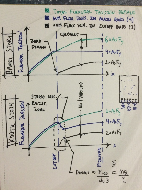

BAretired said:
thus there is no demand on the additional reinforcement at the cutoff point
BAretired said:
If concentrated loads were added each end of the beam between points A and B, keeping the uniform load the same throughout, Mb would increase, creating greater demand on the full length reinforcement but the additional reinforcement would be unaffected by it because Mc - Mb would not change. There would still be no demand on the additional reinforcement at the theoretical cutoff point.
Based on the above statements, I believe that our difference of opinion stems from our telling two different stories regarding the flexural tension demand in the rebar at the cutoff locations. See my sketch below and let me know if it fails to accurately reflect your thinking.
With steel reinforcing of steel beams, the MQ/I story is saying that:
1) Immediately to the left of the theoretical cutoff point, all stresses are distributed in MC/I fashion throughout the unreinforced section and;
2) Immediately to the right of the theoretical cutoff point, all stresses are distributed in MC/I fashion throughout the reinforced section.
Making that pseudo-instantaneous jump is what creates the MQ/I and tension lag demands immediately beyond the cutoff point. My story of cutoff rebar flexural tension demand is consistent with the MQ/I philosophy. Your story is not. And that's not to say that my story is more correct than yours or, indeed, that my story is correct at all. Mine simply parallels MQ/I methodology. I also feel that my story is more compatible with strain compatibility (pun intended). But then, we assume strain compatibility in concrete in many instances where it clearly doesn't exist.
I've reviewed a few of the concrete textbooks that I have on hand with regard to this issue. All simply state that, for a number of reasons, bars should be extended beyond the theoretical cutoff point. And I don't dispute that will produce safe designs regardless of which of our stories more closely reflects the truth.
I was hoping that I could find something in print that would make one of our flexural tension demand stories the clear winner but, so far, I've come up empty handed. I've included MacGregor's version below for reference. It deals with overall, mobilizeable code capacity but doesn't say much regarding the expected stress in individual bars.
I agree that the precise stress in the bars in the vicinity of the cutoff is not too clear, particularly when bars are terminated in a tension zone. For that reason, I tend to extend bars one development length beyond the theoretical cutoff point.
In the case of the WF reinforced with a WT, there is a similar problem. The stem and flange of the tee are by necessity, unstressed at the physical end of the tee. The flange is unstressed for some distance beyond that because of shear lag in the stem, so the prudent designer would take that into account when determining the length of the WT and would likely call for continuous weld in the portion beyond the cutoff point. That would be a matter of engineering judgment.
So far as the full penetration weld along the stem of the tee is concerned, I tend to agree with one of your earlier statements that to distribute the weld uniformly between the end of the tee and the point of maximum moment as we do for example with shear studs in composite beams, is not a prudent course of action because the welds are not as flexible as shear studs. For that reason, the weld metal should be distributed in a manner compatible with the shear flow along the stem of the tee.
