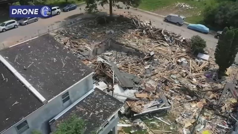

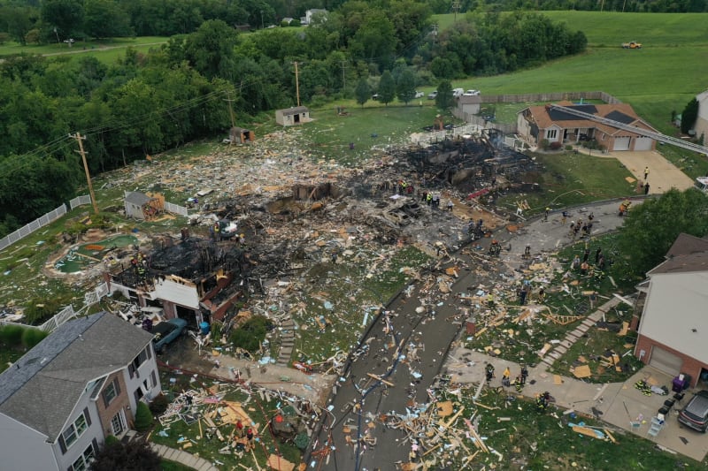

A hot-water tank and leaking gas pipelines or abandoned wells?

That's some explosion. That looks more like propane. Pipeline or well it would still be burning after.
That's a gas cloud gone up.

Can't see a water heater casing that sort of a bang unless they filled it with propane...
Actually that second link is rather telling "AmeriGas confirmed that a propane tank is on the property, ...."
The homes apparently didn't have a natural gas supply.
But this was four kids and their granny by the look of it.

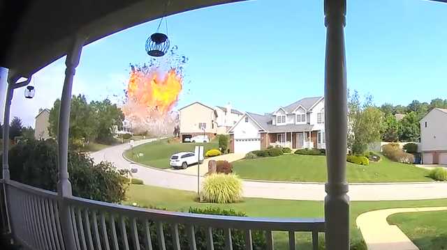

But are there two separate explosions or just one?
It doesn't look like a gas explosion to me. It's looks slower and the flame is not shaped right. Flames appear dense. Gas blows up in all directions. Lot of upward direction here. Maybe because the origen was in the basement?
Comparison?

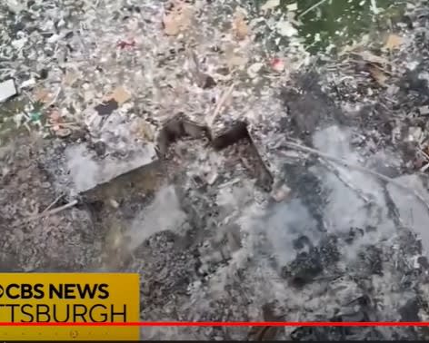

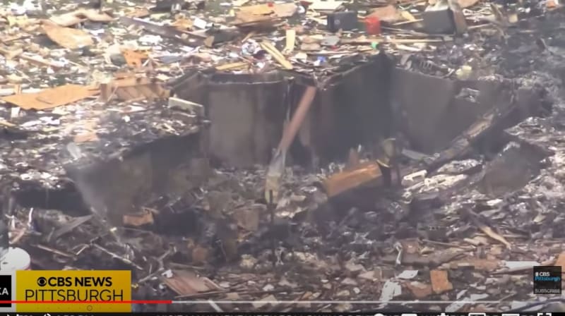

Couldn't see it originally due to debris, but there seems to have been a substantial basement.
Don't know why or how they cam out and said it wasn't the gas supply when all indications are that it was. The follow up news reports show the gas company going round turning other homes back on.
Some shots of the now partially cleared basement.
