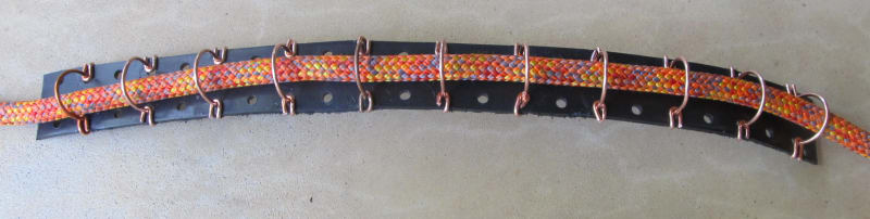

And here's the cambium saver/rope guide. It's got stiffeners on the other side to form an inverted U to fit the limb or crotch, and it just hangs in place. I keep a nylon string through it to pull my rope up for climbing. Several have been in place for over two years in yard trees that I climb repeatedly.
