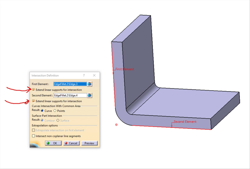

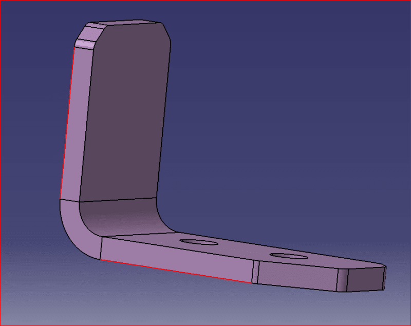

Oct 30, 2019 #1 CAD2015 Computer Jan 21, 2006 1,932 US Hi, It may look childlike, but I'm still asking this question: How could I create a point at the intersection of the two edges (highlighted in the picture)? I haven't found this option under point creation, either in Part Design and GSD......... CAD 2015

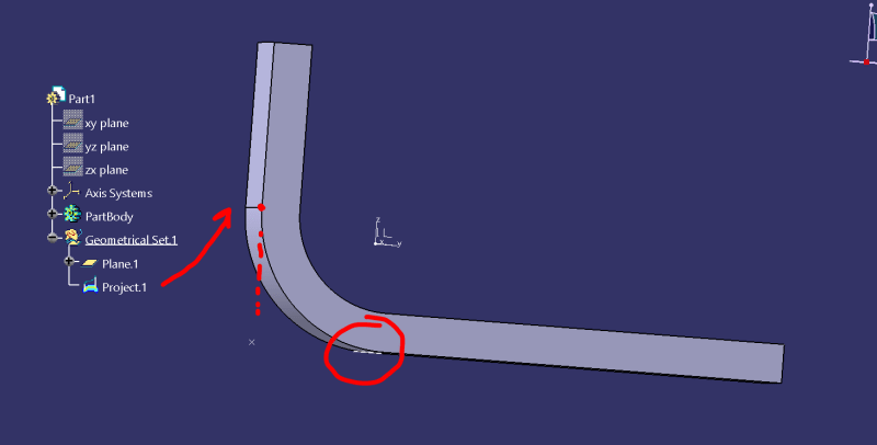

Oct 30, 2019 1 #2 catiavbmacro Automotive Nov 13, 2018 89 BA Hello, maybe like this? [link catiavbmacro.com]catiavbmacro.com[/url] Upvote 0 Downvote

Oct 30, 2019 2 #5 rickyt Automotive Jun 26, 2002 233 US try using intersection with Extend option selected. Upvote 0 Downvote

Oct 31, 2019 Thread starter #7 CAD2015 Computer Jan 21, 2006 1,932 US RickyT: Your option is perfect! Fast and efficient! Thanks a lot! CAD 2015 Upvote 0 Downvote
