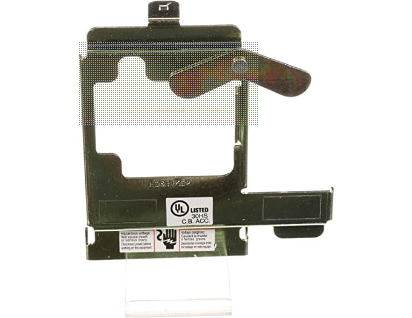

A Poor man's transfer switch:
Siemens has these available to convert a standard load center into a transfer switch.
It interlocks the top mounted breaker with the upper lefthand breaker position.
The picture should be rotated 90 degrees clockwise.
The opening fits over the main breaker and the pivoted rocker interlocks the breaker handles.

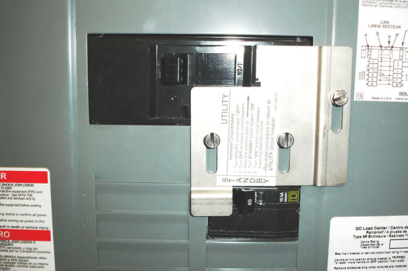

Here is the Square D version.

Those interlock plates are the bomb! You can get them for about any make of breaker panel. Heck you can get them for any make on Amazon! There is no excuse at all for not making your generator install safe-for-morons. Gotta be the cheapest liability insurance there is.

I have one of those Siemens interlocks myself, and it has worked great.

Be careful the interlock is listed for your panel.
