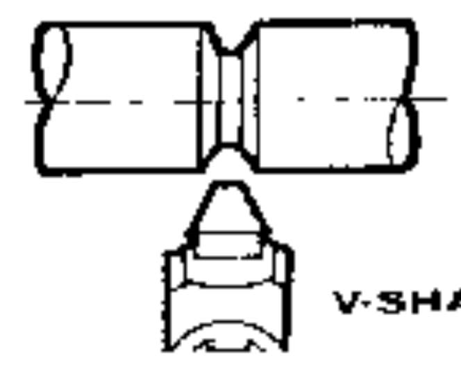

An example is a carbide insert used to perform an angled groove like in the attached picture.
The shape of the insert is akin to a flat taper, but it is actually tapered in two perpendicular cross sections (there are clearance angles).
Everything is usually defined with toleranced dimesnions, but symmetrical widths are often defined with Position tolerance. The control is sometimes required at the exact theoretical depth of cut location from the front edge.
