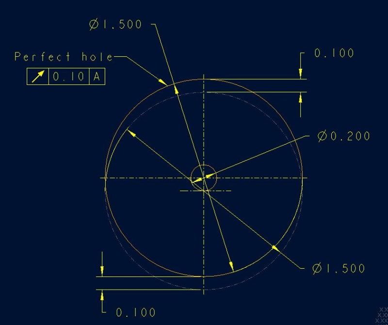

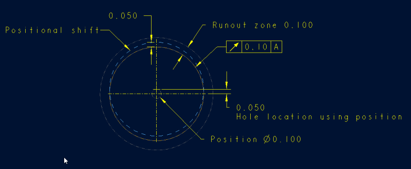

I did that. Can't the zone be all in one direction? I'm defiantly no measuring expert, put the gage on the surface, set to zero and rotate. Can't the gage go from 0 to 0.010 and still be to print?
My example attached is using 0.100 for ease of viewing.
Yup - the hole moved 0.050 and the runout was double that amount, all other factors being perfect.

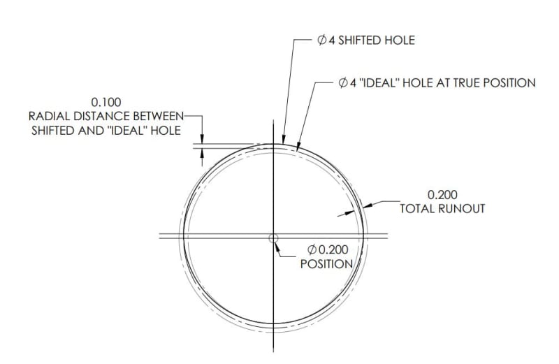

pmbov,
Your runout zone is not shown properly. The entire surface must fall within the runout zone (two cylinders spaced 0.1 apart) - the way you have it shown the feature (shifted blue dotted circle) violates that. A cylindrical feature of perfect form shifted off its axis by the full amount allowed by the position tolerance (position tolerance = 0.1) will result in an identical amount of total runout variation (runout = 0.1). Obviously things get much different when form variation is taken into account as the article greenimi posted (8 Apr 20 15:09) shows.
chez - it is a possible runout zone, just not one that corresponds to the offset shown by this particular feature. :)
Not sure how I missed that the runout zone limits weren't tangent, but I'll go with blurry image sampling for an excuse on this one.

A dial indicator at the 12 o'clock position will be down -0.100 and then drop to 0 at 3 o'clock then to +0.100 at 6 o'clock and then back up to 0 at 9 o'clock before returning to 0.100, for a total travel of 0.200.
pmbov,
The deviation you have shown actually results in 0.2 runout, not 0.1 so it would be nonconforming. The radial distance you have labeled at the top and bottom of your figure to the "ideal" or perfect hole is the same as half the position deviation (again - for a feature of perfect form).

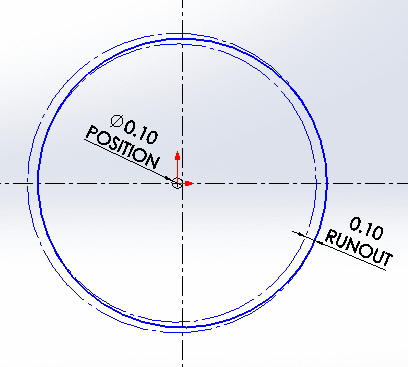

Apologies for the lack of color - solidworks does not have an easy way to change the color.
ok in conclusion, |runout|0.10|A| = |position|Ø0.10|A| and are treated equally in a tolerance stack. Correct?
For conformance purposes, no. See the article that greenimi posted earlier. (
I don't want to say yes or no definitively, and it depends on what is being evaluated (max axis deviation, min/max wall thickness, clearance, etc..) and assumptions made - perhaps someone else can chime in. Total runout can allow form variation which would have a UAME with an axis outside of that allowed by the position tolerance. And the position tolerance can allow form variation in the surface which would not be allowed by total runout. If we're talking about circular runout (which is the symbol you have shown in your examples) that complicates the matter even further. Whether these max/min cases evaluated for the purposes of a worst case stack would be significantly different - I'm not entirely sure.
