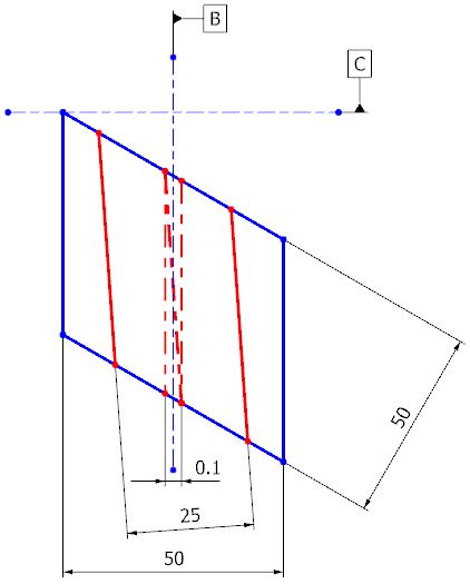

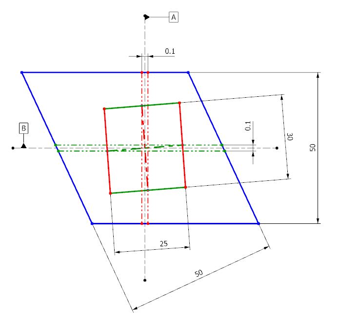

I've included a sketch of the distortion which I assume is similar to what you mean.
Here is my understanding. Do correct me if I am mistaken.
Since Datum A, B and C are defined to be perpendicular in the drawing, it remains perfectly perpendicular no matter the outcome of the manufactured part. If I were to use the labeling convention in the first picture, the tolerance zone is defined with respect to Datum A and B respectively and are technically perpendicular to each other. This, I believe is as shown in the picture above. In this case, the perpendicularity between DIM 30 and 25 is limited by the size of the tolerance zone. If desired, I could add a separate perpendicularity control frame to the "vertical" edge w.r.t. Datum A to limit the extreme distortion between the two outer surface. However, as of this moment, I do not see the necessity to add the additional two datums to the positional control frames like in the second picture, as I think that it does not contribute to additional control to the inner walls of the square hole.
Viewed from the top, where Datum A is on the viewing plane, I believe that the outcome will be as shown below even when using the convention like in the first picture. In this case, if I am concern about the perpendicularity of the hole to the "horizontal" edge, I could add a perpendicularity control frame w.r.t. Datum A and B to limit the distortion. However, in this case, the tolerance zone for DIM 25 is still perpendicular to datum C. I still do not see how adding two more datums to the positional tolerance control frame for dimension 25 will provide additional control.
Or are the Datums also supposed to distort according to the distortion on the parts? I don't think so. Perhaps I am missing something here.

A few loose thoughts:
- Datum feature C reference as tertiary in the 2nd scenario adds no value to both position callouts.
- The first sketch showing distorted datum features A and B and the two position tolerance zones does not correspond to any of the two scenarios given in the first post:
--- If it was per the 1st scenario, the vertical position tolerance zone would be rotated to align with the center plane of the actual/distorted width A; the horizontal position tolerance zone would stay as is.
--- If it was per the 2nd scenario, the vertical position tolerance zone would be rotated to align with the center plane of the actual/distorted width A; the horizontal position tolerance zone would be perpendicular to the vertical one and centered about a center plane constructed from a smallest envelope contracted about the extremities of the actual/distorted width B.
- As of now, none of the two scenarios contain an orientation tolerance between datum features A and B, therefore the distortion you shown between these features on your subsequent sketch is theoretically unlimited.

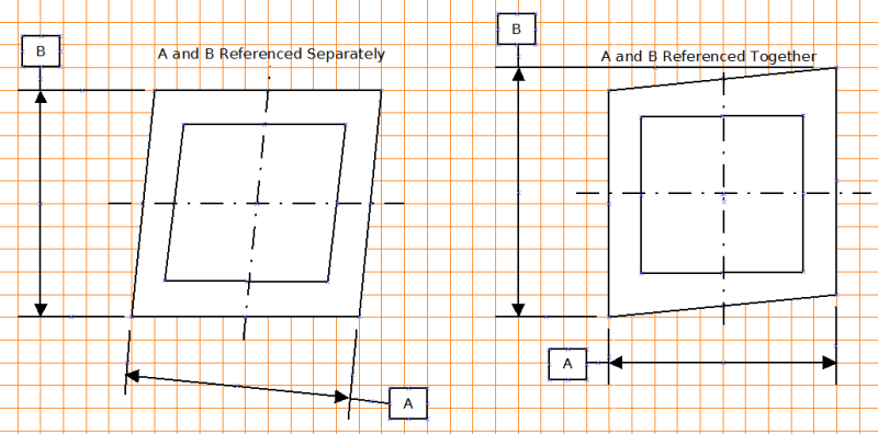

The relations between datums is controlled by the Feature Control Frames.Datum B is not required to be perpendicular to Datum C if only Datum B is referenced and vice versa.
You need to look only at the constraints the datum feature references apply one at a time per each feature control frame.

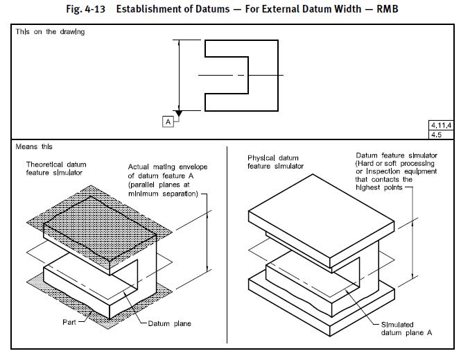

Pmarc and 3DDave, thanks for your pointers and sketches. I see now that I have understood the derivation of datums incorrectly.
Referring to the following content within ASME Y14.5:2009 has also helped in clarifying that the Datum features affects the Datums orientation, in a way.

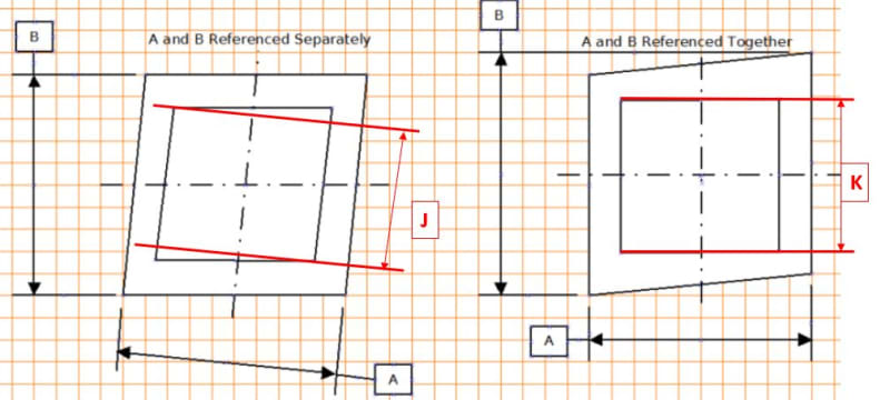

Going back to 3DDave's sketches, if I were to add a perpendicularity tolerancing on Datum feature B with respect to Datum A, am I correct that the outcome for both sketches will be almost similar? One main difference that I can think of is that if the width perpendicular to Datum A is critical, value K will always controlled better than value J.
