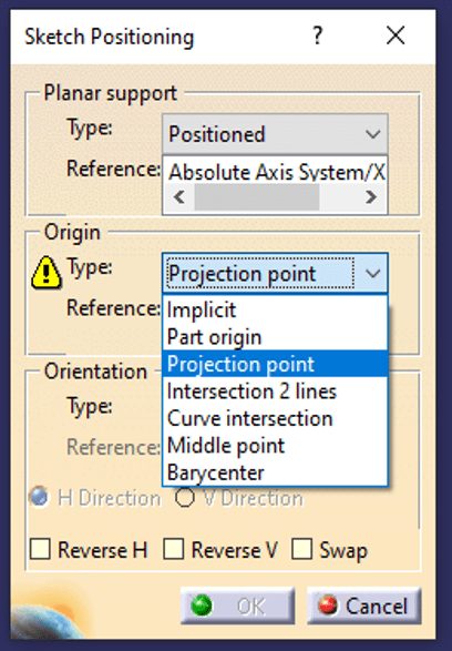

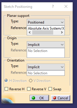

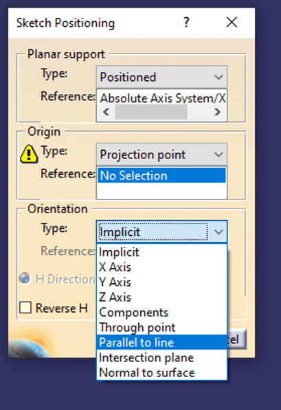

Hello, here a few pic
So i need to select these from the menu and the give those input from selection.
Start with running Spy++ tool and checking if all controls are available as windows.
Then search for "Sketch Positioning" window using it's name with FindWindow function.
After that use FindWindowEx to get child windows.
To select specific item from listbox use SendMessage.
Note that after each call you have to wait for "Sketch Positioning" window to process inputs (and possibly redraw itself adding new controls).
