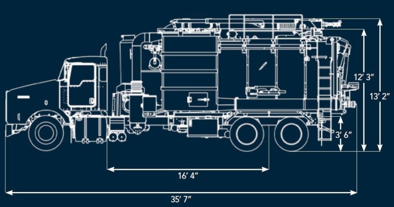

I finally got a little bit information and want to may be ask this question for the truck in below pic with total growth weight of 44,300 lbs, is the existing bridge (designed for HS-20)okay?
I mean is the below truck below or within the designed load for the bridge?
Thank you for your continuing help.

HS-20 is a design load that should exceed or meet the worst case of legal loads. For the weight/truck you indicated it's difficult to tell unless you know how much load is on that tandem rear axle.
Based on the questions you are asking I feel you shouldn't be undertaking this design and should consult with a qualified bridge engineer. I'd also reach out to KYDOT as they likely can assist you in the legal requirements you must undertake to load rate and post the bridge.

I can't say for sure whether that truck would rate as well as the HS-20. Technically, it would depend on the weight distribution and the length of the bridge. What I can tell you is that it appears very similar to our Type 3 legal load rating truck, which typically rates over 50% higher than the HS-20 for our bridges. I can't see that changing much except for maybe a bridge with very short spans (less than 30ft).
I can also tell you that somewhere around half of the public highway bridges in service in the US were designed for HS-20 live load. Those hundreds of thousands of bridges are used by millions of trucks of every legal configuration on a daily basis. There are maybe a few with major damage or severe deterioration that may be posted, but the vast majority are not. If the DOTs in all 50 states are not concerned about that, why is the owner of this bridge?
