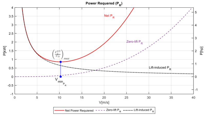

Hi there,
i am currently a 2nd year aerospace engineering student am i am stuck on the concept of power required curves! From my understanding of the equation everything component of Power required is a function of velocity and therefore as velocity tends towards 0 so too does the power required. However, when looking at every power required curve it always seems to tend towards infinity when you approach 0 velocity. Can anyone please explain why and then how i would further be able to plot the line of power require without it ending up at 0!
Thank you
Oscar
P.S I have attached my current attempt at plotting it

sorry i may not of explained myself correctly ! In theory my graphs at 0 velocity should tend towards infinity please see example image attached.

How did adoubling of velocity in your top graph lead to power required giing up by a factor of ten?
It appears you only included drag from boundary layer friction in your graph and did not include the induced drag from the required lift. As velocity tends to 0, the Coefficient of lift required to remain in the air goes to infinity and then so does the induced drag.
This is a typical drag curve ...
lift induced drag falls (rather counterintuitively) as speed increases, and
profile drag (what you've labelled as "zero lift" drag) increases with speed.
produces a minimum drag at some speed (in your example at about 10 m/s).
