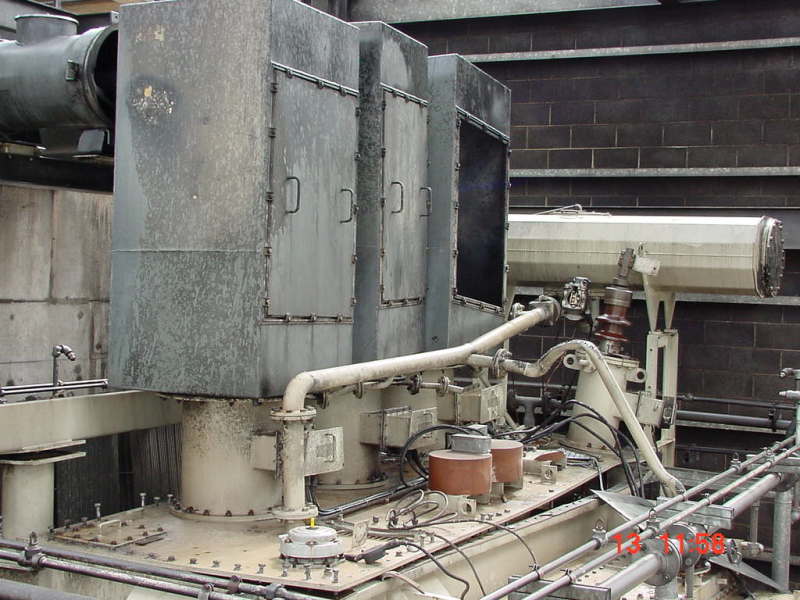

Just so you appreciate that the PRD really doesn't guarantee to prevent a tank rupture:
For a sense of scale, the top plate is 40mm thick and the cover bolts are M24. The Buchholz relay has been torn in half toward the centre right of the image.

Exactly my point; the PRD cannot protect the transformer from a fault.
Since the PRD can only respond to slow rates of pressure rise that the SPR cannot detect and moderate expansion rates from decay heat following successful trips by the much quicker SPR, then (ipso-facto) it's purpose is really to protect the SPR and should be set-up accordingly.
Hi Bambie,
My point is that the energy release was so violent and massive that the transformer was doomed regardless of the SPR / PRD / Buchholz because the fault can't be cleared fast enough for an alternative outcome. The fastest-acting relays would be the differential schemes, but they are still limited by the breaker operating times. When the transformer is completely destroyed, protecting one minor component isn't worth worrying about.
