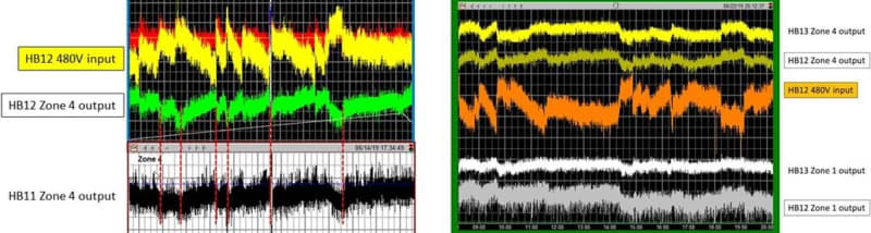

Hi, to start my degree is in micro electronics so power distribution isn't my strong suit despite working through college as a journeyman. The journeyman stuff was why I have been asked to look into this.
Anyway, on the 480 volt power to some of our crystal furnaces we have some regularly occurring transients that our process guys insist are affecting yield. These are +- 1% which is well within the spec for incoming power. I have confirmed that it is most likely incoming power as I have seen the pattern on two different substations. Supposedly we do not have automatic power factor correction or on load tap changers and can't say those would match the data. Any idea what would cause the changes shown in the pic below?
Since the process engineers insist it affect their yield I will have to mitigate these changes. I am thinking either a rotatory or battery UPS. Can you suggest anything else I might want to look into?

Furnaces are 48kva and heat to ~1200C. Voltages/power matter because the liquid/solid interface is held to within +-.01 C of the melting point or as tight as they can get it. It is hotter toward the liquid side and cooler on the solid side by a few tenths over a few feet. The 5 volt tap change causes a brief spike or sag that the PIDs catch but they are set to very slowly adjust and are over damped I think. The 30-90 minute changes of 5 volts don’t cause a problem. The idea is to start crystallization at the seed and keep a uniform lattice structure while moving the transition zone over the melt (like 6 feet per week). Cool spots, eddy currents and other things cause unwanted crystallization, localized changes in the metal ratios and a host of other issues.

Here is a chart showing the input 480 voltage and the DC heater power on different units and zones. The furnaces were custom made in house 30 years ago because they couldn't find one designed for the job. The controls have been upgraded, heater elements get changed out regularly but the basic design has remained the same. They are experimenting with several new versions now and they recently hired a whole slew of materials and chemical engineers to bring the yield up from the 20% range now that volume has grown to the point where they need much more materials monthly.

Well too.. There's your correlation Bill in v6racer's latest graphs.

It is also possible to use the measured input voltage value as a feed forward input to the temperature control loop. Then if the input voltage varies the controller output would instantly change, without waiting for temperature change to occur first. This may be what the graphs are showing us is actually happening. What is the definition of "zone output"? Voltage, current, power, control signal? It would be good to see actual temperature variations on the graphs. If input voltage is changing, a controller output should be changing to compensate, in order to keep temperature constant.

All of the graphs have been data collected by the controller. Zone output is the SCR power output going to the heater element. There are multiple RTDs sensing temperature in 8 different major zones and 4 minor zones around the transition area. The heat up rate is limited because two of the metals produce an exothermic reaction when combined that can blow apart the furnace if allowed to go too fast. That's why I said the controls where over damped.
That does not seem to make sense. You want the SCR output power to stay the same regardless of the AC input voltage. If the input voltage goes down the SCR's should stay on for a higher duty cycle to keep power constant. The graphs show that the output goes up when the the voltage decreases. This would make sense if the graph represents the signal going to the SCR power controller, which is calling for the SCR to stay on longer to keep power the same. I think you are confusing the two. The signal to the SCR power controller is going up in order in order to keep the power output constant as input voltage goes down. That is a good thing.
