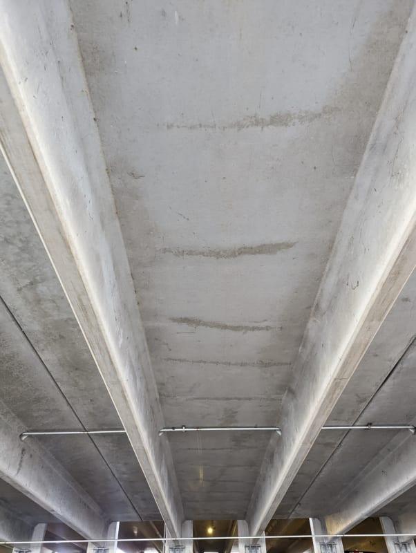

Hi -- I recently did an inspection of a parking garage in Jacksonville, Florida. These cracks in the underside of the precast double tee's were seen fairly frequently. In some cases you can see what looks like rebar peeking through. No cracks were seen on the topside in the middle of the span which did not have a topping. There are visible stitch plates. Almost all exposed rebar and cracks on the top deck were at the edges where it appears concrete was placed on site with poor cover and curing process. There was no recorded rain fall in the 48 hours before my visit and the weather was in the high 80s (I felt it!).

Ribbed slabs are precast. Insufficient curing is not impossible but sounds unlikely, they're made in a factory.
Insufficient cover might be the culprit, although in garages this type of corrosion appears sooner or later even with proper cover.
Carbonation of concrete reduces protection of rebar due to loss of alkalinity (Link). Other factors too. Everytime it rains, concrete is soaked.
Spalling at joints it's quite common, either traffic loads or joint stresses, or both.
To be honest it doesn't look that bad, I'd say small - moderate damage. The problem is there, but is probably at early stages. Wouldn't be able to know how corroded is the rebar inside without a proper survey (half-cell?).

No real advice on documenting inspections, but I do hate this type of parking structure. There have just been too many collapses for me to feel comfortable about using them. But the big problems are at the connections, not in the individual members.
The longitudinal crack is at mid span and is likely flexural; it doesn't look too bad, but over time this may change. The transverse cracks are likely flexural, too, but caused by the pretensioning strand putting the top fibres in tension. Parkades are likely designed for a LL = 50 psf and during a large part of their lifetime, may not have any load at all. This is particularly noticeable for long spans. Parkade double tees often have a span in excess of 50'.

Corrosion is another item that has to be carefully reviewed and with parkades, even repair can be an issue (see halo effects).

I'm for insufficient cover. think we might be seeing welded wire fabric showing through on the bottom? If so, that does not portend well for the transverse flexural capacity of the flanges.
Somethings that make me doubt the mesh guesss:
1) I'd expect the tighter wire spacing to run the other way.
2) I'd not expect to see so much curvature along the wires.

If I had to guess, I'd say those "snake" marks on the bottom of the member might be mesh/rebar supports? They look ~2ft o.c.? Not sure why they're all snakey though. Even still, I'd only expect to see the "feet" of the supports, and not the "conduit" looking patter as well.
Upside-down?? Musta been training a rookie at the plant that day.
Yes, those are slab bolster marks, so not of concern. And the transverse cracks are restraint shrinkage cracks. The ribs don't shrink as much as the thin slab. The longitudinal cracks are flexural. I don't see any indication of corrosion in those photos, but the whole thing is exposed, so in the future...
Again, pay attention to connections to the supports. And study previous parking structure collapses in Jacksonville and Atlanta, some of which have been discussed on this site. Nasty.
I have another “theory” on the soffit snake marks.
These look like cracks that have been epoxy injected where the technician used 1/4” wide tape as a injection port, and cap sealed between the tape, upon curing the tape was removed and the crack injected. Successive “ports” were sealed with wax, upon which the cap seal was removed after the injected resin cured.
