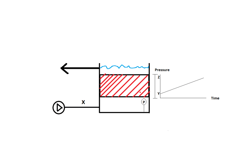

I am trying to understand what a certian pressure at the bottom of a tank would be.
I have attached a drawing trying to sketch the problem.
The pump is pumping water in at at the bottom with a fixed volume/hr and pressure .
The water then travels through some biomedia which results in a pressure loss Y, this loss increases to pressure loss Z over time but let us assume a pressure of X.
And the of course the water column with a pressure of W.
What would the pressure transducere show at a given time?
Pressure X plus whatever the head difference is between your pipe and the tank floor.
But where are you measuring pressure X?

The pressure trancducer is used to meassure the water level in the tank, but inspite of my recommendations they also want it to control the pump.
Thanks again.
First, X will always read at least W + pressure loss across the filter = W + delta_F.
Secondly, if the pump can supply more pressure than W, say W+ p, flow will start through the filter and delta_F will begin to increase with flow passing through the filter resulting in P reading W + delta_F, which will also equal = X + the pressure equivalent of the distance from pump discharge elevation to the tank floor.
It should be no problem to use P's reading for controlling the pump's discharge pressure provided that you set it for the pressure corresponding to the level in the tank W + delta_F, deltaF being equal to the pressure drop across the filter when flowing at some discharge rate Q. If Q will be constant, it is pretty easy. If Q will vary, then you will need to develop an appropriate delta_F vs Q relationship to add to W.
It boils down to this: Do you want pressure control with a feed worward based on the bio bed d/p. In part it depends on your pump design, it's min flow requirements, and whether you have a pupmp recycle valve or a variable speed pump.

However if the pressure below the "biomedia" changes over time, it won't be possible to use a PT on the tank bottom to calculate level as you won't know if the extra pressure is due to extra level or just extra DP across the "biomedia"

Hi all,
Thanks for the great discussion, just to clarify what this is used for:
This is a bio filter with biomedia in the red area, this area will get gunked up with all kinds of stuff during operations over time.
The whole idea here is that there is a constant volume pumping through it all the time, no variations, this is controlled by a flowmeter (my bad for not mentioning this).
When the pressure drop across the medium gets to big, a cleaning cycle will start.
During this cycle the pump will shut down, the water column lowered, and air injected to move the media around and clean it.
My concern here is/was if the pressure transducer will see the increased pressure required to pump through the filter or what it actually will read.
Hope this helps.
Again thanks for the help.
Yes it will see the pressure rise and IMO you should set the pump to turn off and the cleaning sequence to begin just before you get to some safe maximum operational tank level, at which P = W_max + delta_F_max, delta_F_max being the maxium pressure drop across the filter that you will allow before cleaning is required.

Can you revise your diagram to show us where the other pressure guage is that you're using to measure the DP across the filter?

there is not any seconday pressure gauge to meassure the drop over the filter. The idea is to use the tranducer at the bottom of the tank to meassure the increase in pressure from the pump.
As i understand from the posts above, it will see P = W_max + delta_F_max, delta_F_max being the maxium pressure drop across the filter.
Thanks again!
Then you can't use it to determine height of the water in the tank.
It only works to understand pressure drop when the water level is fixed.

That can be calculated from hydrostatics. P - height to filter x density is the pressure at bottom of filter. 0 + depth to filter x density is the pressure just above the filter.
Even if the water level rises or falls, it will add, or subtract that same pressure diffeential to each and every point below, hence pressure drop across the filter is independent of any change in water level. That only depends on the amount of sludge caught in the filter.
But there's only one pressure measurement.
If you have two variables (pressure drop across the filter and height of water in the whole vessel above the filter, how can you determine which of those is causing your single pressure measurement to rise?
Only if one of those is fixed can you work out the other.
If you have to have the accuracy within a psi or two, of which I'm not convinced that is necessary; it could probably work with a wider range. then the secret is to design the tank outlet so that water level remains constant, or nearly so, across your range of flow rates. You could do that with a float driven gate if you had to, but I think the right size pipe, not flowing full, could work, because flow would increase up to around 60% d. Or you might make a triangular weir to weld in front of the outlet, etc. That just depends on the range of flow rates you have to deal with and the tank's freeboard you have. You might could change that too. Or just give up on that approach and put another gage in there. I think that really isn't necessary though.
