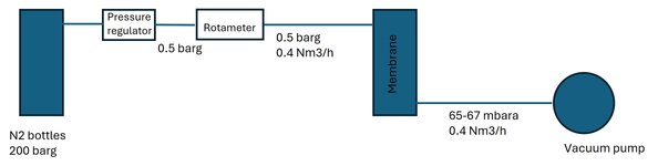

Dear all,
I need to design a system as depicted in the attached image, where I need to feed a fix flow of nitrogen to one membrane under partial vacuum conditions. The setup considers a nitrogen source from bottles and a vacuum pump at the end of the line. The idea is to use a pressure regulator and a flow meter, to feed nitrogen at 0.5 bar and 0.4 Nm3/h, and that the vacuum pump can decrease the pressure in the membranes further to 65 mbar(a). I would like to know how to calculate the pressure profile along the line, from the pressure regulotor to the pump, to know the pressure at which the membrane would be working. Do you know any suitable formula for such setup that can consider pressure losses and the curve of the pump? Thanks in advance!

@Javier Sanchez - You can use a similar technique to the way you would match the curves for a centrifugal pump system. The difference is that you would use the pressure at the *suction* of the vacuum pump.
The upstream gas pressure is fixed by your pressure regulator. The downstream pressure (at the vacuum pump suction) would depend on the pressure drop through the piping and the membrane, and you can plot this on a curve. Similarly the pump flow capacity varies with the suction pressure - assuming constant delivery pressure to atmosphere. Where these lines cross is your operating point.

the document is good and i tried the calculation as
The pipe dia is 1" & pressure drop i assumed is 3" Hg and vacuum need at end of the pump is 65mbar (1.92" Hg) so
as per the document you have shared
P1 = 1.92" Hg V. (65 mbar a) This is required vacuum at the end of the pump.
P2 = 37.17" Hg V (0.5 bar g+ 1 bar atm so = 1.5 bar a ) This is the nitrogen bottle absolute pressure in the line before the membrane.
V1 = 0.235 ACFM (0.5 Nm3/hr) This is the required flow rate of nitrogen to the membrane.
V2 = Required flow rate after the pressure drop before the membrane ?
I substituted the values in P1 V1=P2 V2
V2 = (P1/P2) * V1
So i got 0.607 Nm3/hr vacuum flow rate required for 3" Hg V Pressure drop at 1" line.
i avoided the regulator & rotometer pressure drop values and length of the line.
I think i have done a mistake or some wrong understanding of the concept. can anyone please correct me.
Asisraja,
P2 is wrong , 1.5 barA =44.2951 inch HG
Attached another document about compressible fluid flow.

thanks for correction
As 0.4 Nm3/hr is 0.68 ACFM. and as you told 1.5 bar A is 44.2951 inches Hg.
V2= (1.92/41.29) * 0.68
= 0.0316 ACFM. 0.0537 Nm3/hr.
I think i should have read them again and clear the calculation part.
