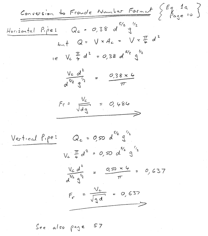

@shvet - The most comprehensive document I have found is the one by Gilles Corcos.
The value of 0.31 is the limit below which effectively none of the vapour is entrained downwards with the liquid. A value of 1.0 is generally regarded as sufficient to guarantee that a siphon will form rapidly. As the Froude Number increases from 0.31 to 1.0 progressively more vapour will be entrained. The value of 0.64 is often quoted as an overall average for pipelines.
In this case with a vertical downflow section it would be safer to use a value above 0.6 but the higher velocity and therefore pressure drop would be a constraint. We do not have flowrates or pipe dimensions, so I have no idea what the best compromise will be.

@katmar
Fruode number does not even mentioned in document shared.
@shvet - My humble apologies. You are absolutely right. The only mention of the Froude Number is in the footnote on page 57. It is a while since I used this book and I had forgotten that Corcos used a different way of expressing his equations.
I have attached my hand written notes that I had made in the book for converting between the systems - again my apologies for the untidiness.
I still believe that the Corcos book is the best source of information on the subject, but it takes a bit of translation.
You probably know of other non-English sources and I would appreciate your comments on which sources you have you found best for this data.
