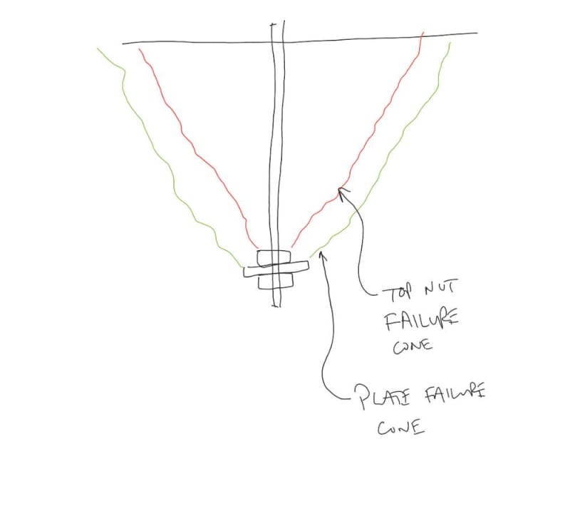

You can make the washer a 1/4" plate washer sandwiched between 2 nuts to deal with the flimsiness issue of standard washers, my old company used to spec that all the time.

strucbells- I still don't like the plate between nuts detail. See the sketch below. The top nut is going to be a lot stiffer than even a 1/4" plate washer. Take a 3/4" anchor rod - the nut is going to be about 1/2" thick, and the shortest distance from the edge of the rod to the outer face of the nut is only going to be about 1/4" for heavy hex. Compare that the flexural stiffness of a 1/4" plate with a diameter that puts the outer face of nut to outer edge of washer at an inch or more. So while the washer will resist some load, the vast majority of the resistance will occur at the nut. I think the nut failure cone is the failure that would happen, though perhaps at a slightly higher load than would otherwise be predicted. The big issue comes when somebody uses the washer diameter as the bearing area, since I think that overestimates the capacity of the connection (both by overestimating the effective area and underestimating the embedment depth, albeit by only about 1/2").

As long as you treat the plate as a belt and suspenders and only design for the bearing area of the head, you should be fine. The plate washer really isn't needed, though.
