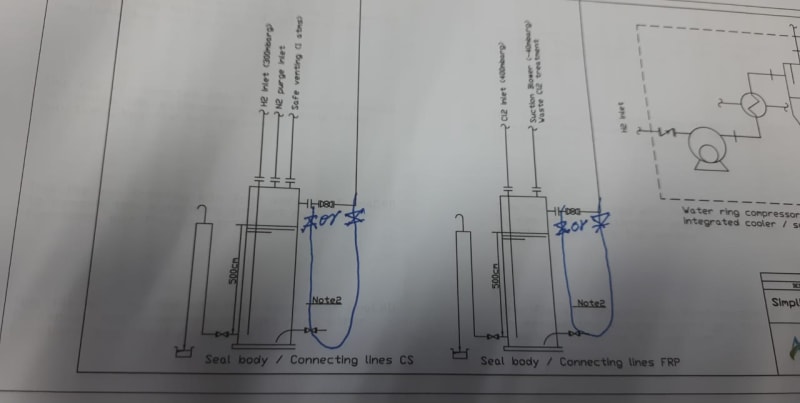

Cl2 & H2 should never mix ...but I have a situation where I have H2 compressor, H2 seal & Cl2 seal being fed by same water line.
What if x2 events happen simultaneously:
1] Supply water tank become empty so water line is empty
2] H2 seal is CS (carbon steel) & the immersed line can develop pitting holes & small H2 can be present in the top ullage of H2 seal
...in case 1st event is true this H2 will be sucked into Cl2 seal via empty water line (bcz Cl2 seal is under suction)

You asked "what if", not how to control it.
It would seem that when any seal water tanks go low, you need an alarm and when it reaches low-low, or if the previous low alarm is not acknowledged by the operator, a process shutdown sequence needs to activate. Closing one valve does not appear to be sufficient.
I think a U-Bend at feed water line can be regarded another safeguard
First rule is eliminate the risk.
So the CL tank should be fed by a separate tank or a separate water line. Only if there are very good reasons not to ( and cost isn't one of them)
The tank has a pretty low margin any way (400mbarg CL pressure vs 460 mbarg at 5m with your 40 mbarg vacuum on the top of the water column).
Actually maybe less than that as the 5m shown is water level to top of that external tube, but it's the depth of submergence of the pipe which is crucial. What length is that? Exactly 5m as well?
Loose less than a metre of water and your seal is gone.
As you can see in the illustration it is (dip leg) exactly 5m
Yes...thisnloss of water only occurs if initially seal breaks bcz of overpressure

Sorry, but at concept phase that is really not the right attitude to take and even if you think it is you need to document why and be able to justify it possibly to an external body.
The illustration is exactly that - an illustration, not a detail drawing and it doesn't specify that distance. We can only see what you tell us.
I did specify linear & elevation distances in meters.

So right now we have x3 feasible solutions:
1] Add some digital Level indication to feed tank
2] Piping U-bends
3] ...maybe individual check valves at feed water lines to each seal
On the 3] point. Check valves maybe a problem at small feed flows especially if tank supply is gravity assissted alone
U bends may get their liquid traps blown out if velocity is not well controlled.
Check valves are known for unreliable sealing.
I wouldn't count on either for critical applications. Valve backup would be preferred.
I'd do the alarms with automatic valve closure at low-low, shut down sequence continues as necessary. Tank levels are always nice to know.
I am unable to understand this
So what's wrong with separate pipes.
Accepted 👍
Prevention is always best.
Liquid traps are pressure sensitive, can also trap unwanted air/gas reducing flow rate or causing vapor locks, and subject to unwanted siphon, need a sight glass and you're never really sure if they are there when you need them, especially on startups, when you probably need them the most. Save those for the kitchen sink.
Dip legs acting as safety seals should always be made of some corrosion resistant material. SS316 may be okay for H2, but for wet chlorine, some kind of superduplex stainless steel or titanium.
