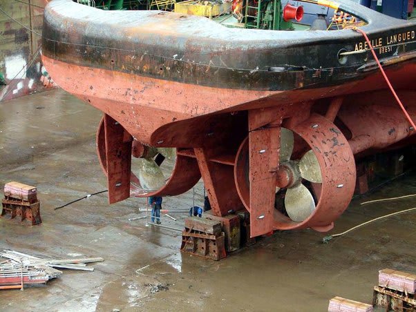

My application isn't a pump but it's similar. Propeller on my boats are distributed pitch props in nozzles. I am having an issue where the low speed load from the prop is too high. Typically to reduce load, one would re-pitch the prop but that would also reduce the high speed thrust. This is a varying pitch prop so it has more pitch towards the hub and less towards the tips. Am I wrong to think that increasing pitch towards the hub while simultaneously reducing pitch at the outer diameter would, maybe, decrease thrust at low rpm and maintain it at high rpm?

Are all you props shrouded?
Drawings or pictures always help!

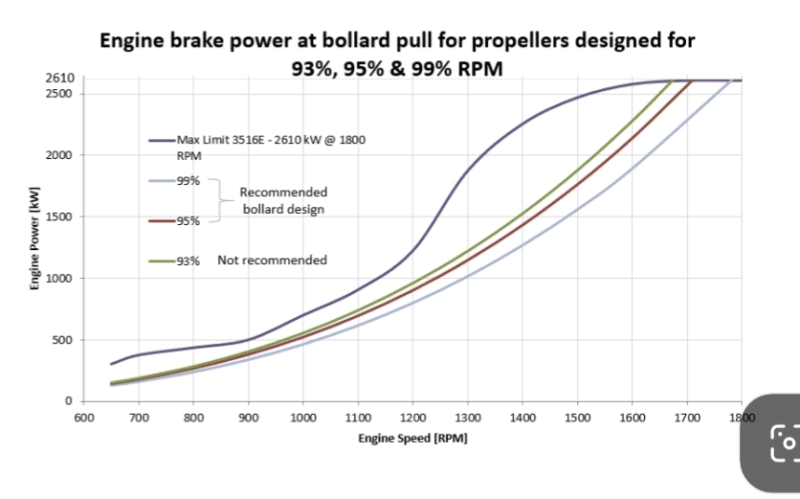

For tugs the propeller is pitched so that the propeller curve intersects with max engine power while the vessel is stationary.
I am having problems in the 1200 rpm and under region where the engine power doesn't sufficiently exceed the propeller power which causing slow acceleration and stalling.

This is coming from my brain trying to understand this on a 2 hour drive, so it may be total garbage but it made sense to me.
Hydro-props are limited in airfoil design due to aforementioned cavitation. Whereas an air, a combination of lift and drag can be used to transfer energy and momentum, in water, since lift=low pressure=cavitation, only the drag regime can be used to effectively transfer forces. This is not purely a downside, since water is much dense than water, a considerable amount more energy per unit volume can be transferred. A hydro-prop's pitch is the balancing act between transferring momentum p=mv and force/energy KE=1/2mv^2. This balancing act (v vs. v^2) shows up axially and radially. It shows up radially with the variable pitch of the hydro-prop due to the relative velocities of the inner and outer portions of the prop needing to be balanced so work is transferred across the blade radial length. It also shows up in the graph you provided in the exponential growth (v^2) of the hydro-prop power vs rpm.
Based on the information you provided the design constraints on a tugboat's hydro-prop design are:
-The most efficient transfer of power and momentum must be at or near the peak power of the propulsion unit.
-Exhibit a performance curve across the rest of the rpm range that most closely matches he propulsions unit power
without exceeding, ie. stalling or losing acceleration.
The graphic you provided shows the prop most closely matching the propulsion unit's power across the rpm range is the 93% but is too close, so any degradation in the propulsion unit's performance would mean stalling or lose of acceleration, so it is not recommended.
The 95% and 99% show a loss small loss in efficiency compared to the 93% across the rpm range but provides a buffer to allow for less than optimal propulsion unit performance, lowering the risk of stalling.
To answer the main question, will changing the pitch alone provide the performance change you are looking for? No
Is it possible to design a hydro-prop providing the performance you are seeking? I think you could but would likely result in much higher in efficiencies. I suspect these are standard hydro-prop designs for tugs that propulsions units are matched to performance wise.
To address your problem of stall and lack of acceleration below ~1200rpm. It appears either a lack in rated propulsion unit performance or an unaccounted for inefficiency in the transfer of power from the engine to the hydro-prop is at issue.
Yes, the problem is a lack of performance of the propulsion unit. The engine manufacturer tuned the smoke limits to exactly follow the prop curve so there is zero margin. The engine is emissions certified and the manufacturer refuses to adjust the tune. Hence I am here looking for ways to reduce the performance of the prop without diminishing the peak bollard pull.
So, performance curve is fixed, propulsion unit is fixed, recommended prop type is fixed. Nice of the engine manufacture to give themselves "going green" gold star by passing the problem on to you.

I thought about ventilation but this is a 10ft diameter prop in an azimuthing pod so piping air to it would be a challenge.
