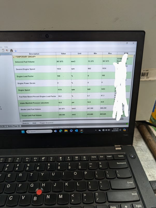

It's an electronic limit based on boost pressure. You can see the smoke limit fuel volume and delivered fuel volume are equal, the engine will not fuel more.

The speed reduction of 7.5:1 is entirely within the Z-drive unit. I am first, trying to avoid out of service time, second trying to avoid dry docking, third trying to avoid buying new props and nozzles.
Assuming you are using a proprietary Cat engine monitoring software. Considered any aftermarket ECMs, and a more generic engine management software used?
I have a workaround but will not implement it due to prison risk.
Understandable, I was going to ask if end users were required to maintain tier 4 requirements or if it was only the engine manufactures, but you indirectly answered my question. Related to my last question, I am assuming all E3516E's have like ECM tuning. I was wondering if there are aftermarket companies that can provide a more specific tune to your needs while still maintaining Tier 4 requirements and certifications.
The problem is that there are only two companies that make high speed diesel engines in this power range and there are very few customers that need tier 4 engines. There is not much interest in us.
Are you constrained by only EPA Tier 4 or also IMO Tier II and EU Stg. 3a?
EPA T4 is the strictest standard by far.
