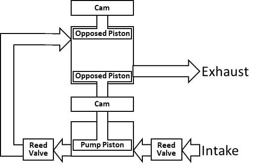

Here's a functional diagram of one cylinder set (of six) in the engine. A pair of opposed pistons share a common cylinder with the upper piston gating the intake ports and the lower piston gating the exhaust ports (uniflow scavenging). A third piston in another cylinder of substantially larger bore pumps air into the intake port. The pump piston's timing is arranged so it is at max volume at the start of the scavenge period. After a bit of time (determined by port flow calculations), the exhaust port closes signaling the end of the scavenge period. The pump piston continues its stroke to complete the intake period, reaching its min volume just as the intake port closes.
From the above, it's clear that an injection system is required to ensure no fuel is passed out the exhaust port. Use of a carburetor would require that scavenge and intake be segregated, and that can't be done without introducing a number of other challenges.
The most complex possible path I'm pursuing is a scaled down version of a classic fuel injector of the unit type; one cam surface driving the piston generating pressure while another controls the pressure bypass valve. This approach requires very fine tolerances and will likely be vulnerable to clogging due to the very small orifice required. In spite of the challenge, I'm currently running CFD on a version of this nozzle scaled down to a .0023" orifice assuming the Swiss Jewel Co. can make the precision parts affordably. Note this injector will have to use pressure multiplying pistons in order to operate with a piston stroke large enough to be feasible within tolerances.
The rich mixture approach (in which a very rich mixture from a common manifold is injected into the cylinder where it mixes with the larger volume of air to yield the final mixture) should be much simpler to construct, but I'm finding it harder to quantify the design criteria.

I guess I still don't understand where this:
RodRico said:
Since segregation of intake and scavenge air flows adds a lot of complexity
Comes from. Intake air is scavenge air and scavenge air is intake air, unless you think that injecting fuel anywhere other than direct injection into the combustion volume somehow means you have to evacuate the cylinder volume twice.
Is your plan to spray fuel directly into the combustion volume, after the exhaust valve is closed, using this jewel orifice injector?
If the pump piston's intake is drawn from a manifold with a carburetor, then fuel will be passed out the exhaust during scavenge. Preventing this would require two pump pistons (one for scavenge and another for intake), and that would add a lot of complexity. Even then, fuel would wet the walls of the passage from the pump piston to the intake port on the opposed pistons resulting in fuel in the scavenge air, so the engine would need separate channels for scavenge and intake. This approach is infeasible given the fact that scavenge and intake have different timing and there's limited real estate for separate pistons and channels to the intake ports.
I do plan to inject directly into the cylinder. This gives the most room for mixing to occur without wetting the walls and ensures there's no fuel on the intake passage walls that would subsequently be passed out the exhaust during the subsequent scavenge cycle. I'm even considering injecting just below the intake ports so injection can occur after the intake port closes. This would have the benefit of recovering the work from pressurizing the fuel (and wouldn't subject the injector tip to harsh exhaust gasses as the intake port doesn't open until the exhaust port is open long enough for pressure to settle near ambient).

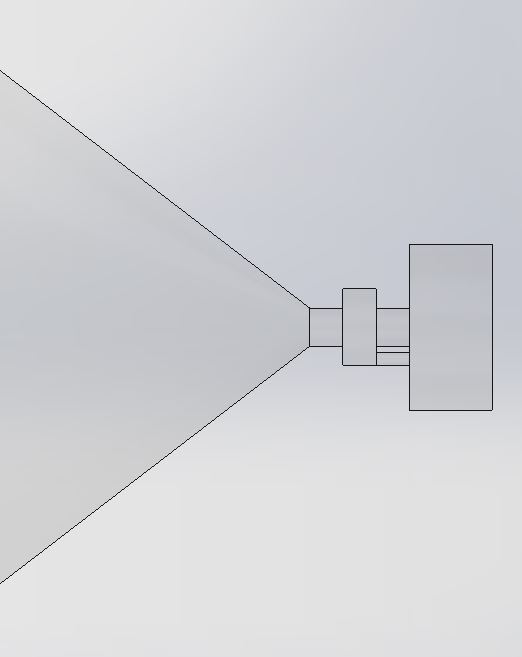

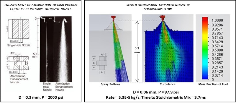

Here's a look at the nozzle for a micro fuel injector using Solidworks flow simulation. The colors are mass fraction of fuel; red is 100% fuel while dark blue is 100% air. For this simulation, I used ethanol rather than diesel because the Solidworks liquid library already had a full definition of ethanol characteristics over temperature and its density is close to diesel (at some point, I'll need to build a library entry for diesel).
The nozzle geometry is scaled from that presented in the paper "Enhancement of Atomization of High-Viscous Liquid Jet by Pressure Atomized Nozzle" using sapphire orifices such as those from the Swiss Jewel Co.. The spray pattern developed using Solidworks looks quite similar to that shown in the paper, but is also scaled. It's tilted a bit due to the proximity to the wall formed by the piston face and appears to break up to zero fuel fraction in only 3.3 mm. The pressure is only about 100 psi to deliver 5.3E-5 kg/s fuel and, at this rate, the entire charge raises to stoichiometric in only 3.7 ms.
The micro injector will obviously need a good fuel filter. I think it would simply be a screen (to catch large particles) followed by a comparatively large disk of sapphire with many holes of the same diameter as the orifice (0.06mm). I'll be calling the folks as Swiss Jewel to find out what they would charge to make these assemblies in small quantities. If the price isn't too crazy, I'll then proceed to design the full injector around the nozzle.

I don't know all the details about your injector geometry but just looking at the orifice diameter you are trying to achieve (0.06mm) and the fact you might want arrays of these holes it seems you are starting to get down into MEMS territory. MEMS foundries can work with sapphire wafers and can etch very fine features so you might want to start researching MEMS and the deep reactive ion etch (DRIE) process that can create higher aspect ratio holes that I think you might need. Be warned though, this isn't a cheap process, especially with sapphire substrates.
hendersdc,
The nozzle as simulated is comprised of three disks. The lower disk with the cone is off the shelf at . The middle disk creates the auxillary chamber, and the last disk has two holes. The middle and last disks are similar to those shown at For all I know, they make these using a MEMS process and if that's the case, I would hope they could run a few customs on part of a shared wafer. In any case, if they want too much for the three disks, I'll explore using one of the many micro-machining shops. The one at offers suitable preceision using wire EDM, for example. There's really no need for sapphire in the prototype and, given the low pressure required, perhaps not even in a production product.
