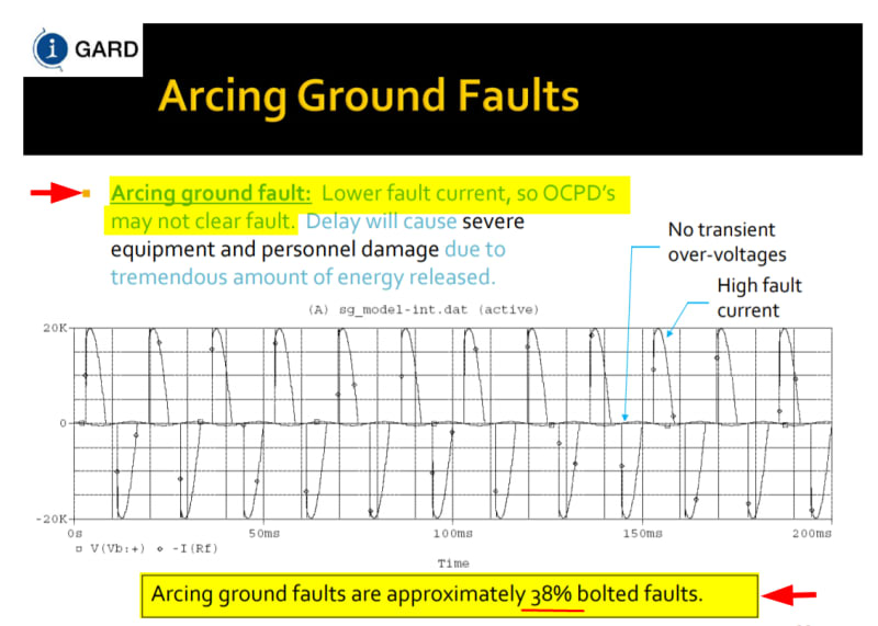

Here is additional info hopefully help with your theory on arcing faults.
Those would be shunt faults, not series faults.
We had a series arcing event recently. Made great middle of the night video, but no relay on the system took note of it.

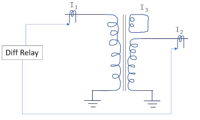

Turn to turn faults in a transformer change the turns ratio, so current at the terminals does change. Think turn to turn fault in a reactor instead.
@Stevenal- can you further elaborate?
In case of turn to turn fault, it will act as short circuit winding.
As shown above current I3 will flow in short circuited winding. But this current will not come into calculation of differntial delay. After inter turn fault, due to I3, ratio of I1 and I2 will not match the expected value.
Stevenal, turn to turn faults will not be like series arcing. True the current in shorted turns can be massive and may melt copper, but the current drawn from line may be only marginally high.Shorted turns will not act as a separate winding but more as a part of auto connected winding. So ampere turns in shorted part will try to match with AT of balanced part of winding. So for detecting turn to turn faults, only sure solution was gas operated relays- Buchholz relays.
That was the situation may be till 20 years back. Now engineers have developed alternate algorithms for detecting inter turn faults in transformers as negative sequence currents, wave form change etc. An Indian professor even wrote a book on this subject !!But still gas operated relay may be the only one relay that acts in such a situation.
prc,
I was trying to make the point that shorted transformer turns were not like a series arc.
But if the shorted turns balance with the ampere turns of the remaining turns in that winding, I guess there will be zero amps in the unfaulted winding (two winding transformer assumed) so the overall ampere turns remain balanced? I don't think so, it will divide up according to ohm's law. Still, you cannot have a turn to turn fault without it affecting the differential current. Whether or not a differential relay will reliably trip for such unbalance is another story. I agree gas pressure relaying or alternate algorithms are needed as well.

Stevenal,the AT balance is like this - let faulted turns in primary be fn and current in loop fi. Then (pn-fn)pi=(ft.fi)+(st.si) where st is turns in secondary. Due to turns differences, increase in primary current will be small and hence the difficulty in detection by conventional relays.
