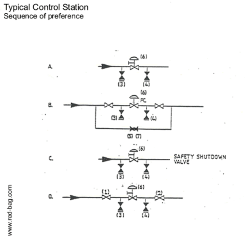

This could be a silly question. Could there be a substitute for a Pressure Reducing valve (PRV). We have to installed a PRV between two pressure zones in our distribution system. To maintain a redundancy in case of the PRV malfunctioning we want to install two PRV units side by side. I am wondering whether a ball valve could be a solution for the second valve? The hydraulic grade line could be broken by throttling the valve until the PRV (Valve 1) is repaired and brought back to service. This will save some money for the struggling County.

When designing a network, it is important to incorporate fixtures that can be maintained with minimal disruption to normal flow regimes, using hygienic operating and maintenance practices. Bypasses for devices such as flow meters and pressure reducing valves should be installed that will allow the devices to be taken out of service for maintenance.
Pressure reducing valves are fairly reliable with minimal downtime. A better choice for the bypass valve will be the globe valve, which is the same style of valve used on the pressure reducing valve.
It seems we are talking about a control station and globe valves are typically used for the bypass line (like bimr says). See B. below.
I appreciate option b turns up, but my normal action it's to redline the bypass valve and delete it. Doesn't matter what notes you put on a p&id, or locked closed, if it's there someone can open it with no instructed system to protect the downstream system. IMHO that's a bad move.
If a control valve is there it's there for a reason. Putting a manual bypass valve there allows some idiot operator to open it and all your carefully considered protection schemes go out of the window.
No valve, can't bypass a pressure control device.

Don't forget block and drain valves!
LittleInch,
Right or wrong, people I have worked with over the years very commonly put double block and bypass valving around pressure reducing valves per Gator's sketch (b). When I worked at a major Canadian EPC which had a huge American parent company, this was even their standard detail.
If there is a specification break across the valve station, we would typically safeguard the downstream piping with a PSV sized for control valve failure. You can also put a restriction orifice on the downstream side of the bypass valve if you are concerned about an overpressure scenario equal to or greater than what you would have to consider for the control valve failing wide open.
But, unless Lan123 has provisions like that, I agree with you; and I most certainly agree that a ball valve wouldn't be my choice in the bypass. I would do a globe.

I accept that there are many of these arrangements, but I've always argued against them in design and hazops. You can guard against failure as you indicate, but it is failure of something. Open a manual bypass and you've lost control, whether the change is fast or slow, manual control is never as good as process control loops.
It's much worse at pressure breaks, but I've yet to lose a reasoned argument on one of these arrangements. Where possible I get to delete it before it even gets to a hazop....
LittleInch,
Fair enough. The answer, then, I suppose, is reliability and / or redundancy in the control valve(s). Different approach, nothing wrong with it.
In pressure regulating stations in our municipal water system we generally use a normally closed gate valve in a bypass around the regulating station. The regulating stations themselves generally have two regulating valves - one for normal flow, the other for fire flows. If the low flow valve fails, the large valve can do an "OK" job of regulating low flows while the small valve is out for service. If the large valve fails, we notify the fire department while its out of service, and if there's a fire, the gate valve bypass can be manually opened.
