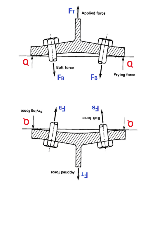

I have a hard time believing the prying forces would be additive. Where are they coming from. If one flange bends a certain about, it's pushing on the other flange which creates the prying action. The idea that this force will be additive if they both bend flanges is silly to me. It's the same force. You shouldn't apply it twice. Tell me why Q in the image below is different if you only have prying on one side? Certainly calculate prying for both flange, but the one that controls is the larger one, not the addition of the two.

Not for the "one way" prying that I showed in my picture. The Q force is the same. One flange pushes against the other flange with the force Q, that flange pushes back with the same force Q. So, for a one way prying action, it is IMPOSSIBLE for the Q forces to be additive. It's just basic statics.
Now, I admit that I hadn't thought of it in a "2 way" prying sense like BA Retired's picture. That makes me less confident in my assertion that the Q forces can't be additive. I still doubt that could be the case, but I'm not as confident as I was when I was thinking of the one way prying.
Note: I'm using one way and two way in a similar sense of how we use those terms for one way or two way shear in slabs. If we're only bending in one direction, the solution is perfectly clear (at least to me). For two way bending, I'm not as confident.

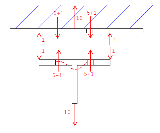

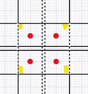

I have been thinking more about this. I believe what happens is you end up with four "Q" forces as shown highlighted on the sketch above. But I still say it doesn't matter if you follow the AISC design procedure.
Agreed.
And your sketch shows the fulcrum moving to a point that is further away, so potentially reducing forces. It all becomes 3D and quickly moves away from a simple T stub analysis but I agree that the prying forces are quite unlikely to be more severe and are not additive.

Here's how I'm looking at this... I'm going to break it down into steps...

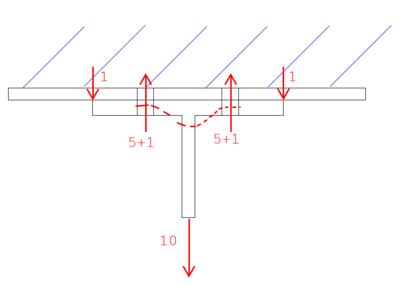

first lets look at the basic tee condition presented in AISC (assumes the tee is prying against a rigid wall or member...)
Every force has to have an equal and opposite reaction for equilibrium, so let's break this up into two free body diagrams and look at those...

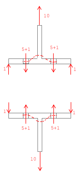

Now let's look at the condition with two equal size tees separately...

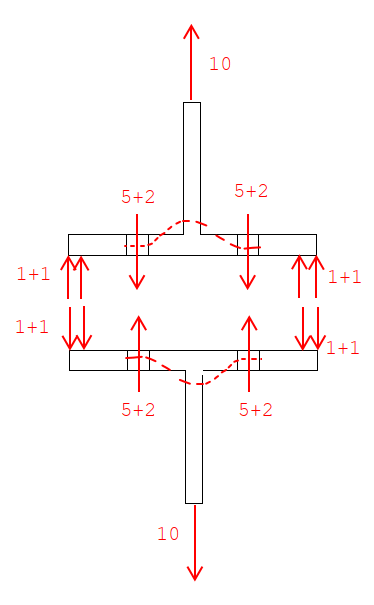

Now let's combine them and apply the q reactions to each opposite member...
This is my argument for saying that the prying forces are additive... I would love someone to model this somehow and prove me wrong.
one hang up I have with the argument that the prying forces aren't additive is the case where you have different prying forces above than below...(two different sized thin flanges)
In this case if you just take the worst case prying forces, where do the other prying forces go? Is the system still in equilibrium?
EDIT - I realize that this one way scenario is different from my original question. This was just easier to illustrate.
