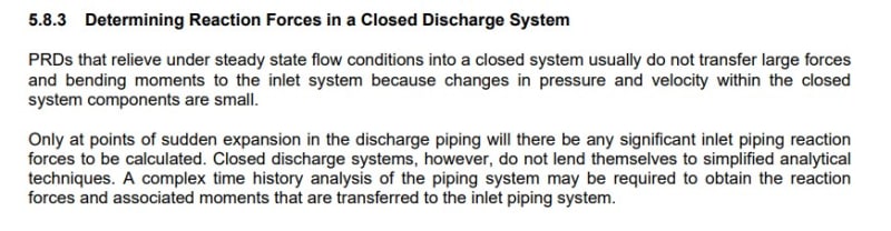

I can't comment in detail on this, but this extract from API 520 Part II (2020) may answer your concern.

Yes, this is the ambiguity I'm referring to from the code.
This statement seems to imply that loading is small enough to not be considered, except at sudden expansion (presumably at the point where the piping connects to the large volume of the flare header). But then goes on to say, a complex time history analysis is needed to confirm this.

The key word in API 520 is "usually".

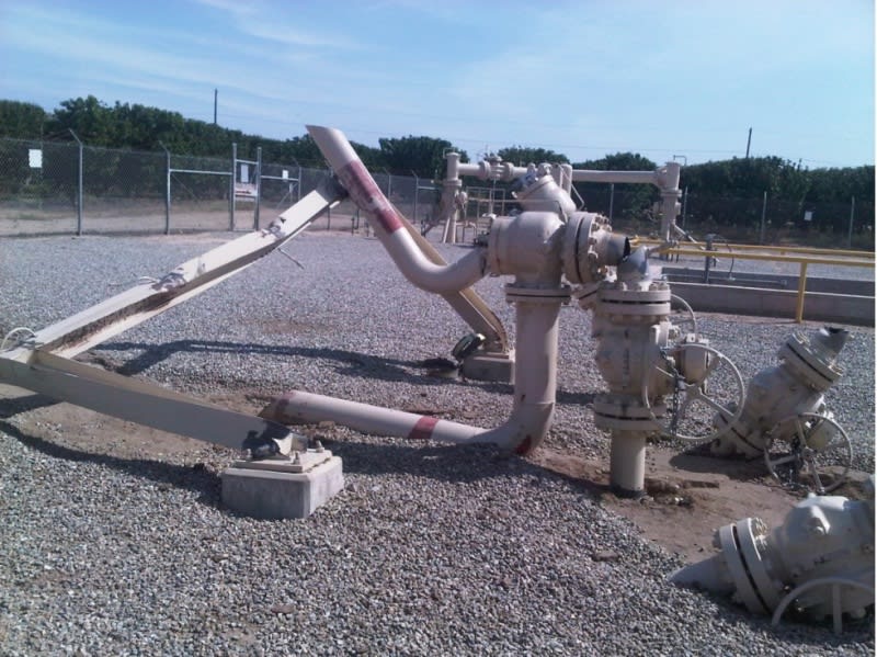

I was looking for that photo!
I know.
Don't lose it this time.
That photo is of an open discharge relief, not a closed system. The jet force is obvious in this situation and needs to be designed for.

It might be an open discharge, but the forces are the same if you exhaust into a nearly atmospheric header. It's only because the header can apply some reaction forces itself and help hold the valves in place that you don't see this sort of thing that often.

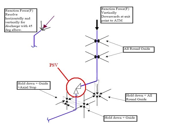

I place the thrust force at the outlet of the outlet pipe.
See "Where to Apply the PSV Reaction Force"
If the outlet of the outlet is far away, not on a blow stack immediately on the valve, as in going into a flare line going to a flare stack, then put it at the end of the first elbow off the psv.
Valves that are attached close to the header may not be critical, since moment arms of the thrust force about the critical joints are short and perhaps the psv flow is not being vented immediately, but continue into a long flare line, hence you have sufficient restraint provided by the attachments to pipe in all directions.
The photo above is an immediate blow off in a high stack to atmosphere, the valve itself also on a high stalk of pipe. All moment arms are long and pipe supports are of miniminal strength, definitely undersigned, probably because the thrust force, if calculated at all, was placed close to the valve in the vertical direction alone, rather than at the top of the stack and maybe the horizontal component of that force from the 45° angle cut on the outlet was not considered.
