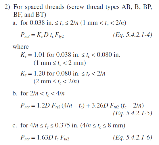

If you're in Canada, CSA S157 does have a relatively easy formula to calculate screw pullout strength in aluminum. Depending on your thickness the strength is controlled by yield or ultimate strength. In the US you'd be looking at the Aluminum Design Manual (uses the same formula as S157) and in Europe you want Eurocode 9.

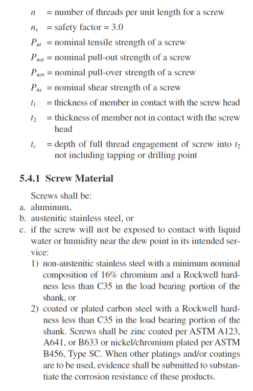

We've almost always used stainless 304 fasteners. We'll use 316 if it's at very high corrosion risk but it's about twice the price. I think some curtain wall manufacturers use zinc-coated steel, which is probably fine too if the fasteners aren't directly exposed to weather. The stainless screws are a bit weaker and "stickier" though so you might need a bigger pilot hole to get them in without snapping, which you'll need to consider in your pullout calc.

Stainless steel screws are appropriate.

Self-drilling screws are just regular screws that drill their own pilot hole. I think you should be fine using the regular screw formulas, with your hole size taken as the drill point diameter (should be on the data sheet for the screws).
From the Aluminum Design Manual 2005 Edition:

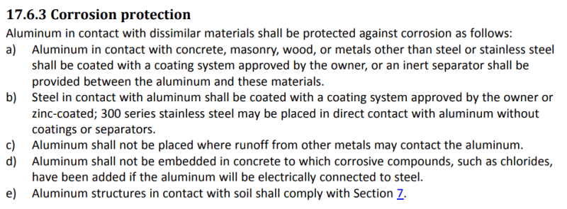

In the Aluminum Association Aluminium Design Manual, it states "Aluminum can be coupled to magnesium, zinc, cadmium, and passive stainless steel in most environments without galvanic corrosion".
For wall cladding, in a really humid, coastal or over aggressive environments, a non-conductive washer or spacer is needed. I have heard of rubber, neoprene, or EDPM washer used. Is one preferred over the other?
Also, in a dry or normal climate (no electrolight), is it good practice to include a non-conductive washer or not necessary?
I don't think a non-conductive washer will do much with self-drilling screws - the threads will still be in contact. You'd use those more typically in bolted connections between dissimilar metals. Often you might even put in a sleeve to make sure there's zero contact.
If you're going with stainless I wouldn't be very worried about it. Go with 316 if you really want to make sure.
From CSA S6-19:
