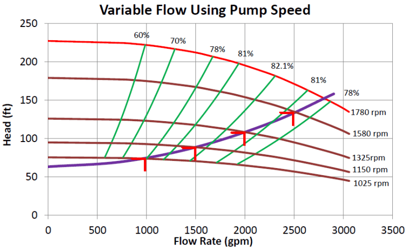

This is a typical speed change curve it will give you some idea of what to expect.
 https://files.engineering.com/getfile.aspx?folder=f629f16c-0662-4e52-9a0a-6ea422c38651&file=Figure-3-Variable-Speed-Pump-Article.png
