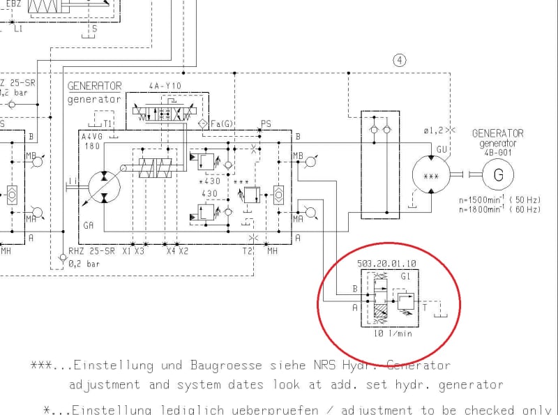

I got a Hydraulic Winch which runs out of two pumps which are paralleled, the winch is rotated by 4 A6VM motors, the whole system is a closed loop system. i got currently a problem where i am losing charge pressure from the compensation pump during winch operation, i suspect one of the motors are leaking inside and causing this issue because we had all pumps replaced not long ago on the system. My problem is that i'm unable to find any data for the flow rate on the Case Drain on these motors (A6VM), any ideas from some one who have experience with these motors on what the case drain flow should look like ?.

Hello Barbicane,
A lot of work to intervene on such a system!
A photo of the A6VM or the Rexroth reference should show if the exchange valve is installed when it is not shown in the diagram.
If there is no exchange valve: when you cycle at low load and high speed, the temperature in the closed circuit rises too high. In this case the viscosity becomes too low and there is abnormal wear at least of the distribution plates of the pumps and motors. You should notice that the gaskets on the pump and motor flanges are burnt.
For my crop: what type of oil is used on these cranes?
Good luck
Hi 73lafuite.
The A6VM's on the system does not have any exchange valves, the only exchange valve i have discovered in the system is the one mounted at the generator pump. on the diagram it is located at the lowest right and has the 503.20.01.10 as a part number. i checked that valve and it is working ok.
i have already taken apart all pumps by now for inspection and i am impressed by how clean they are considering a unit which runs for 3 to 4 days continuously every week. i'm no hydraulic design expert but what i can say is that these machines has been running on the same original hydraulic parts for over 10 years on this design. they do get hot but we never had a problem.
shell tellus 68 is the oil that is being used.
