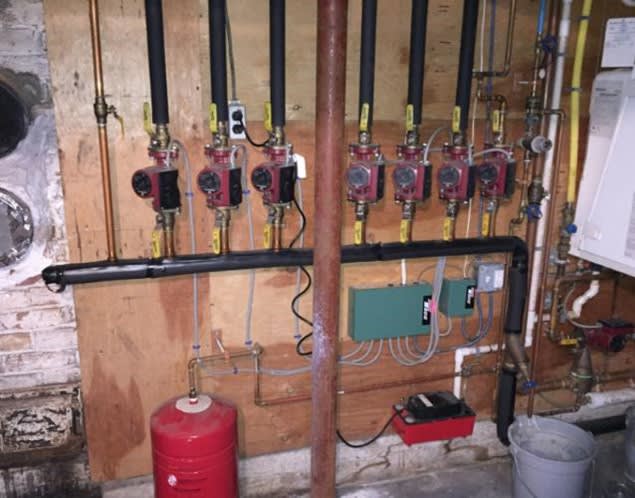

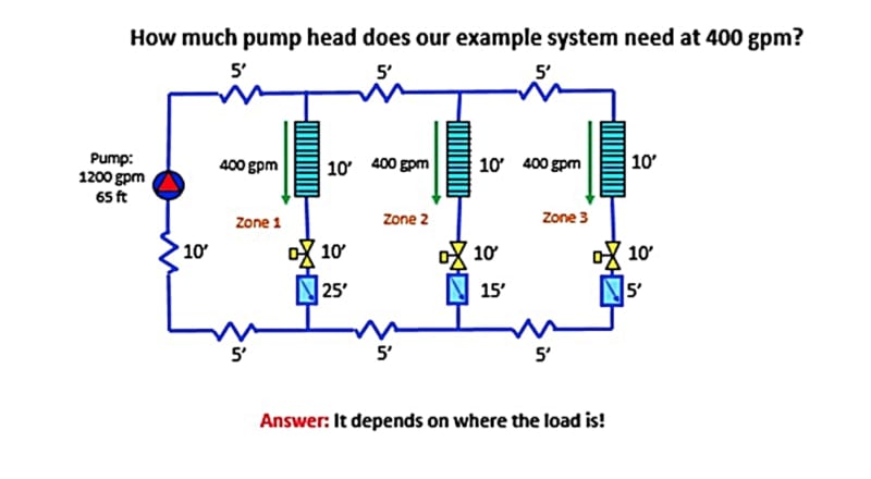

My first thought when you posted is that you are using zones to heat, maybe not. You can use multiple pumps or multiple valves to zone HVAC:
Zones
Zoning
