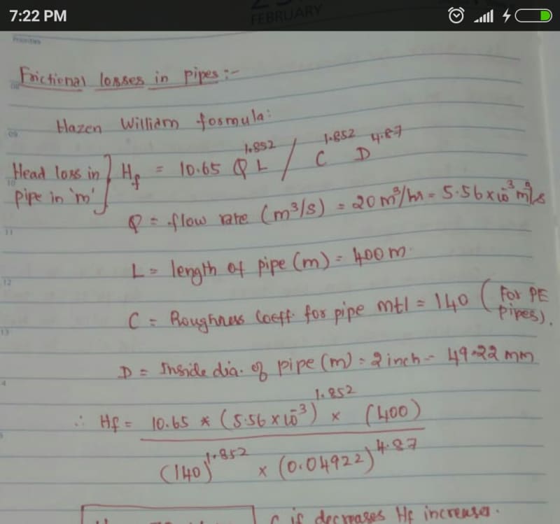

Respected members,
I have attached the Friction head formula. It calculated as 21.18 meters for the below inputs.
Q=20000 liter/hour
L=400 mtr
C=roughness coefficient=140
Dia 2.5", thickness is 7.01 mm ID= 58.98 mm
So Total dynamic head:
Static head = 20 meter tank
Elevation = 22 meter
Filter losses = 4 meters
Friction head = 21 mtr. as said in the beginning. Attached image has the calculation.
TDH = 67 mtr.
As Artisi advised we will lay new 3" pipe and redesign.
One horrible thing our supervisors did earlier was put a High HP motor and the pressure gauge shows reading. They assumed it as the Head.
How to properly calculate Head using Head using pressure Gauge?
Thanks,
Why so you have 20m static and 22m elevation.
What is the difference between supply level and delivery level - that's the static head.
How about a sketck with levels etc. shown.

No idea what all that was about.
But, increase the internal pipe diameter without any other change and the resistance to head for the same flow will reduce - end of story.
Actually the change to head loss is the change of diameter to the 5th power, but beware, the calculation needs to be on actual dia. not nominal diameter.

vij,
The other poster is just quoting the basic way you should be approaching this issue, which is to match the pump to the system.
Now how your two pipe differ I don't know. But please investigate what the actual ID of the two pipes are.
A 2.5" GI pipe is probably about 2.5" ID, but a 3" PE pipe is probably 3" OD - ID??
So your "bigger" pipe might actually be smaller inside??
Also where is the gauge relative to the pump (height and distance from the pump discharge nozzle?
