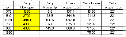

Using your coefficients for pump head and system
curve, I get 620 rpm
To produce a flow of 3451 gpm at 54.6 ft head.
That requires 57.6 Hp at the pump shaft
And a pump torque of 487 ft lbs
Vfd will run the 1780 speed motor at 620
A 75 Hp motor will produce 221 FtLbs of torque.
Torque during runup with a vfd is constant all the way to 1780 sync speed, here 221 FtLbs
That is lower than the 487 needed.
The motor will produce 620/1780 * 75Hp = 26.1 Hp at 620 rpm.
Lower than your duty point which needs 57.6 Hp
Constructive criticism greatfully accepted.

Pavan,
I don't understand where you got 45 htz from for the motor?
The synchronous speed of your motor is 1780 rom which is a 60Htz 4 pole motor.
Speed is proportional to frequency, so 690/1780 *60 = 23 htz. VFDs usually have a fairly fixed V/Htz ratio, hence the reduced power as well as reduced torque.
So unless you add a gearbox then you have the wrong motor.
Why can't you just buy the correct sized fixed speed motor pump set?
Using bits and pieces lying around, somehow fitting both of those on a base plate and then the added cost of the VFD compared to buying what you actually need doesn't seem to make any sense.
OK. BTW Thanks for providing the pump and system curve coefficients. That made checking it a lot easier than usual and gave us a common base to work with.
LI, right, the 45Hz threw me a loop too.
This is a common problem with VFD controlled motors. When run at 1/2 speed they only produce 1/4
In the beginning I was thinking something was amiss with sizes and capacities. The lower rated speed of the pump masked the effect on the hydraulics when it's speed was only slightly reduced (25%), but the effect of the 60% speed reduction of the motor brought us back to reality rather quickly. Benefits of VFD often evaporate completely when below 50% speed. Here it is only a problem for the motor.
Let's see if anybody else has any comments. Electronics is my weak suit.
