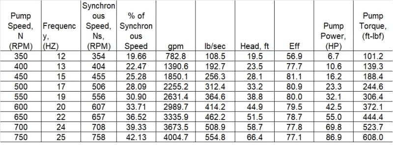

The data I generate is as follows
I am unable to calculate the full load torque, as I have to calculate the pump flow rate, head and efficiency at 1780 RPM. The pump efficiency is at 890 RPM and calculate lower RPMs using Sarbu Borza eqn and higher than 890 RPM. How do get the full load Torque in thus case as the pump is rated only for 890 RPM but the motor goes up to 1780 RPM.

Hi 1503-44,
I have plotted the % of the Full Load Torque Vs. % of Synchronous Speed for the pump using the data I calculated. Please see the data below and the curve. By calculating the Full load Torque as 5250*75/1780= 221 ft-lbf. I got the % of full load greater than 100% in the data points which does not make sense. Request your help to resolve this. Also after this I will have to overlap the motor side curve on this.
Thanks and Regards,
Pavan Kumar
"I got the % of full load greater than 100% in the data points which does not make sense."
Your motor cannot supply any additional torque, more than 221 ft Lbs. Your system curve effectively comes to a halt there. Sustained running may twist the shaft and cause the motor to fail.

Hi LittleInch and 1503-44,
The motor vendor replied back to me that the 75 HP motor cannot provide the Torque as it is capped at 437.5 ft-lbf and I need 444.4 ft-lbf to operate at 650 RPM. He suggested that we use a 125 HP motor. I thought since we can increase the Torque by reducing the speed using the VFD ( donot want to use a belt drive), I can still use a VFD and get the required Torque.
I need to operate the pump at 668 RPM to get the duty point. The full load Torque of 75HP 900 RPM motor is 437.5 ft-lbf(=5250*75/900). If I use a VFD to reduce the speed to 668 RPM then the Torque provided is
T2 =(N1/N2)*T1 = (900/668)*437.5 = 589.4 ft-lbf.
where T1 and T2 are the Torques at speeds N1 and N2 RPM respectively.
As per my calculations, see table below, the Torque required by the pump at 700 RPM is just 523.7ft-lbf. Since I think I can operate up to 700 RPM (47 Hz) and not above.
Please let me know your thoughts.
Thanks and Regards,
Pavan Kumar
"I need to operate the pump at 668 RPM to get the duty point. The full load Torque of 75HP 900 RPM motor is 437.5 ft-lbf(=5250*75/900). If I use a VFD to reduce the speed to 668 RPM then the Torque provided is
T2 =(N1/N2)*T1 = (900/668)*437.5 = 589.4 ft-lbf."
Torque available from 900rpm motor = 5252 * 75Hp /900 rpm = 437.5 ft lbs
"As per my calculations, see table below, the Torque required by the pump at 700 RPM is just 523.7ft-lbf. Since I think I can operate up to 700 RPM (47 Hz) and not above."
"The motor vendor replied back to me that the 75 HP motor cannot provide the Torque as [COLOR= #EF2929]it is capped at 437.5 ft-lbf."
You need 523.7
[/color]
