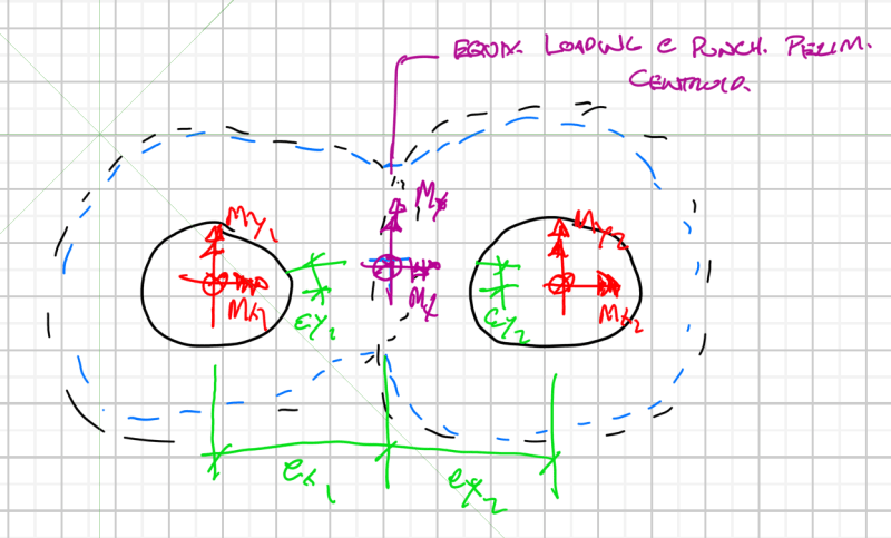

You can use some engineering judgment to create a punching shear perimeter around a "group" of pile or columns or such. Typically, when I have done this (using the American / ACI codes), I have still used the moment aspects of punching shear. It's actually relatively easy to do if the perimeter is still a rectangle.
However, when the perimeter is NOT a rectangle, it gets crazy complicated to include moment. So, I either only check pure punching, or I use an "equivalent rectangle" for the calculation.
agree with joshplumSE - you can create one perimeter around two or more piles - add the loads up and use the 2D from the rectangle formed by the piles.

In close enough proximity I would think you need to work out:
- Centroid of the combined critical punch perimeter
- Static force transfer of the pile reactions/moments to the critical punch centroid
