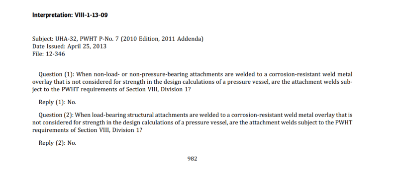

Dear All,
Please note that we are currently manufacturing a tube bundle which is a replacement for one of the end users.
The complete bundle is SS410 material (Tube-SA 268 TP 410 ,tubesheet -SA 182 F 6 a Cl 2, baffles,Sliding bar and support plates-SA 240 410S). The existing equipment(bundle & shell) is not subject to PWHT . However our welding engineering has raised the concern that the bundle needs to be subject to PWHT because of clauses in tables UHA 31-1 & UHA 32-1.
The baffle thickness is 10mm Thk and there is 6mm fillet welding of baffle to sliding bars. The sliding bar is 26mm Thk which is welded to the tubesheet (groove welding-13mm up and down). tube (19.05 OD *1.65mm thk) to tubesheet (170mm Thk) is strength welded (1.2mm weld).
I would like to have your advise on PWHT requirements because of welding of SS410/SS410S.
Thanking you .

@goutam_freelance,
thank you so much for the above post. But this interpretation says when attachments are welded to a corrosion resistant weld metal ,so will this be applicable if a sliding bar is welded to a tubesheet or if a sliding bar is welded to the baffle.
Jerin
JJ, note that those interpretations are related to weld overlay material.
And are your parts non-load bearing?

Finally it ended up as complete PWHT of tube bundle : Yes
Couldn't convince the QC of exemption for PWHT for welding of non-pressure parts like tie rods and sliding plates.
Anyways thanks for the replies.
Jerin
Sorry for delay in reply ! I could not locate any further relaxation in PWHT requirement in Sec VIII-1. I would imagine that you could build a weld overlay and weld the sliding bar to tubesheet to obviate the PWHT requirement. This may be a suggestion for future.
