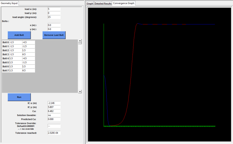

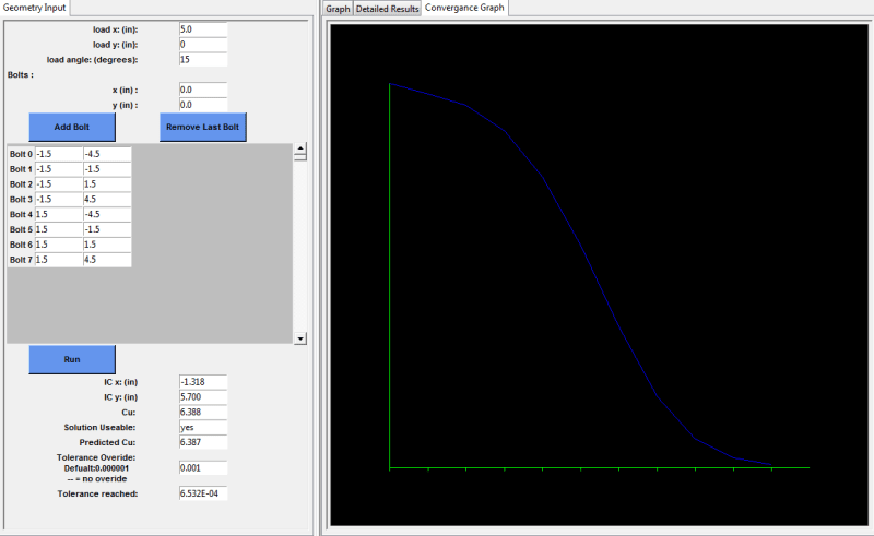

I added a convergence graph to my gui here is what happens to my version of the Brandt algorithm if I keep the precision too tight, 0.000001:
vs a tol=0.001:
Open Source Structural Applications:

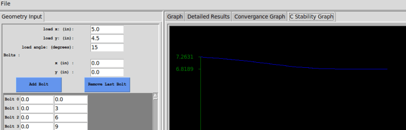

I've added another chart showing the stability of the C factor across the calculation iterations. This can aid in making an educated decision on whether the smaller tolerances needed sometimes result in a C that is relatively stable or not

I solved my issue, with very small eccentricities the ax, ay step size proposed by Brandt ends up being too large and you get to an equilibrium of over/under shooting the actual IC. Using the same equations for ax, and ay but dividing them in half or by 10 takes more iterations to find the IC but lowers the risk of overshoot.
