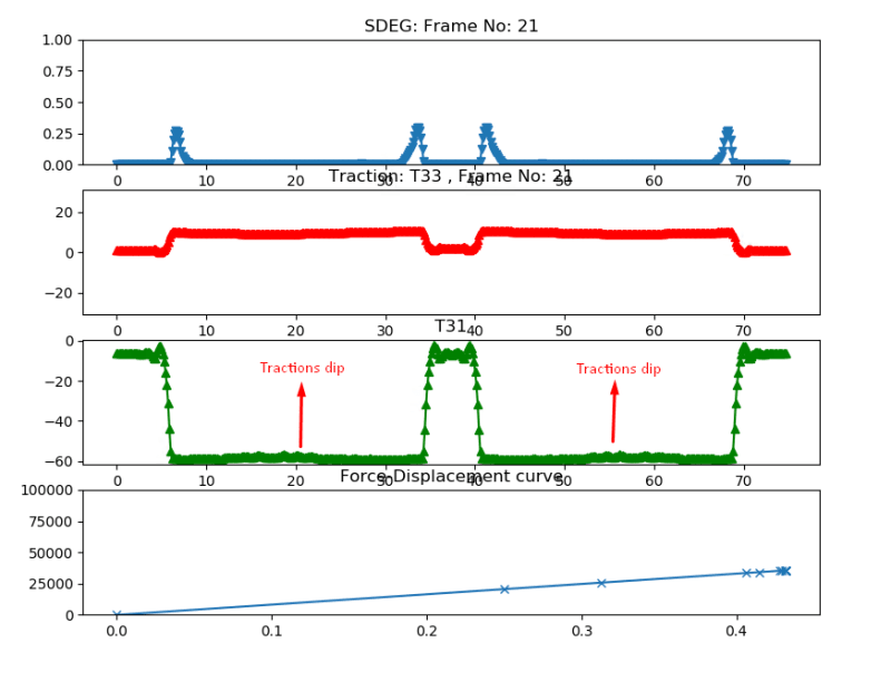

What is really interesting when looking at the tractions is that they sort of "dive" long before frame no. 128. This dive occurs around frame 20 to 30 where damage slowly starts propagate. Damage is observed by looking at the scalar damage variable SDEG.
It is hard for me to conclude whether or not this is something unphysical that occurs due to the numerical damping induced from the dynamic implicit analysis, or it is simply a stress-redistribution due to increased in damage, since the kinetic energy/ALLIE is still below 5% at this point.
A similar thing observation happens when I just use automatic stabilization, although the traction dip occurs before damage propagates. It seems that this may occur due to a rapid increase in the damping used, while in the implicit dynamic analysis, the numerical damping is a bit more spread out over the increments, so that the SDEG and tractions plot follow each other more nicely.
Anyone care to comment on the final observation regarding tractions?
