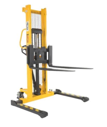

Similarly to what takes place during pit stops for race cars, I'm exploring possibilities for a lifting jack to raise and lock autonomous robots up in the air for wheel changing.
I have a variety of models ranging between 500 mm to 900 mm in width, 800 mm to 1300 mm in length, very short height of 300 mm which means the lifting needs not be high. The heaviest model weighs 250 kg, all have simple shapes like roughly a rectangular box, but their ground clearance is very low: 27 mm.
I'm looking for ways to elevate the robots and have it be a 2-person job at most, like a downscaled version of what you see lift race cars, able to slide underneath very low to the ground. Or perhaps a hydraulic solution?
Thanks for your thoughts.

Try looking at manual forklift or pallet lifting.
Might need to adapt it a bit by say making the robot drive onto a raised platform which has the forks at ground level.
This ones quite good. You can extend the solid feet or even turn them back wards and add a counter weight or bolt it to the ground to stop it falling over?

Air bags can do the lift quickly. Just make sure you have a block or stand to support it before the wheel comes off.
Some sort of stand is a good idea, of course, but any of the above are likely less dangerous than the OEM jack, used on the side of the road, that comes with any car :)
Thanks all for the helpful suggestions and links.
Take a page from Indy cars: build the lifts into the robot so that they can raise themselves. Could be as simple as connecting them to a source of compressed air and a little cylinder at each corner of the robot extends downward. Disconnect the air and they slowly retract.
